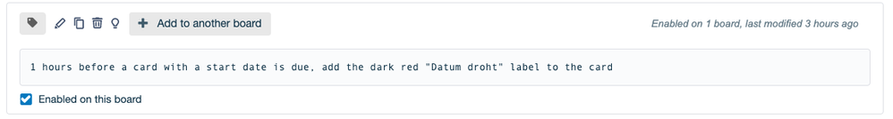

By the way: There is a rule that seems to be working with start date in the due-date register:
As you've probably discovered, that rule is still for due date, but with an added filter so that it only works on cards that also have a start date. It just doesn't care what the start date is.
