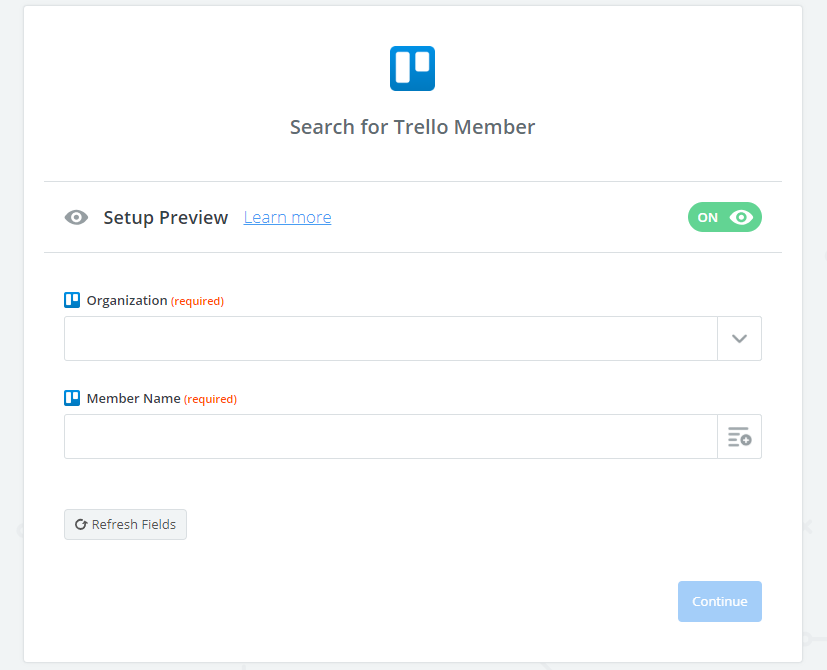

I have tried to use Zapier but I stumble into issue which requires organisation, when trying to use the function of "Find Members". I can't seem to change my board from Private to Organisation. See print screen
Has anyone ever tried this or any other solution to make it working?

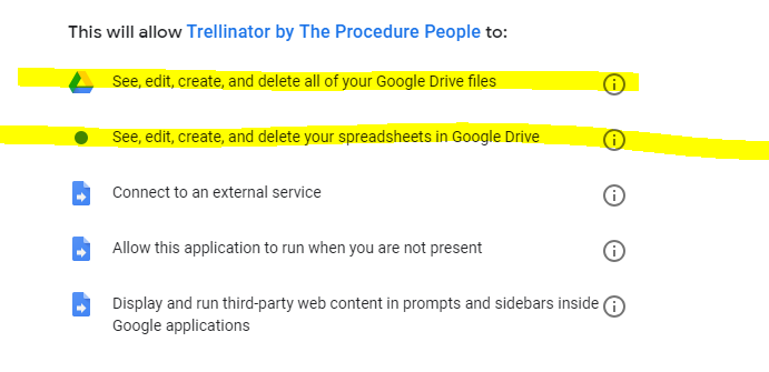

@Jason Tan The script you're providing access to is the code within the document. So no-one else can see, edit, create and delete all of your google drive files, but the code that is in that document can.
