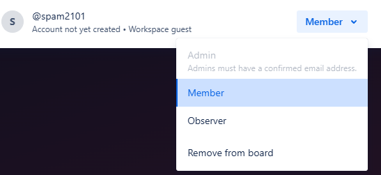

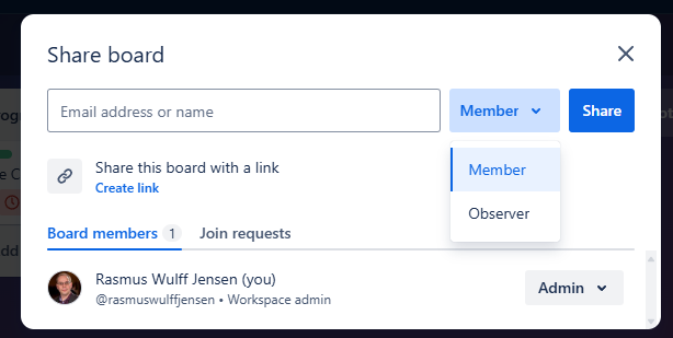

  • The odd one at first is why Admin Fail in Email invite on both Free and Paid, but there is actually a very simple answer... It is just following the logic of Trello itself. If you look at the Trello Interface invite screen, you will see that you can't choose Admin there:
  • So you can't choose it either in the API (aka bad member type)... The only way to invite a member to be an admin on a board is to invite them as a normal user and then change their membership type to Admin after the fact (after they have confirmed their email)
So there is no bugs or wrong type in the API. Just the same logic as the Trello Interface

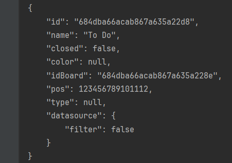

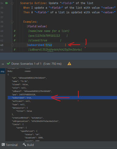

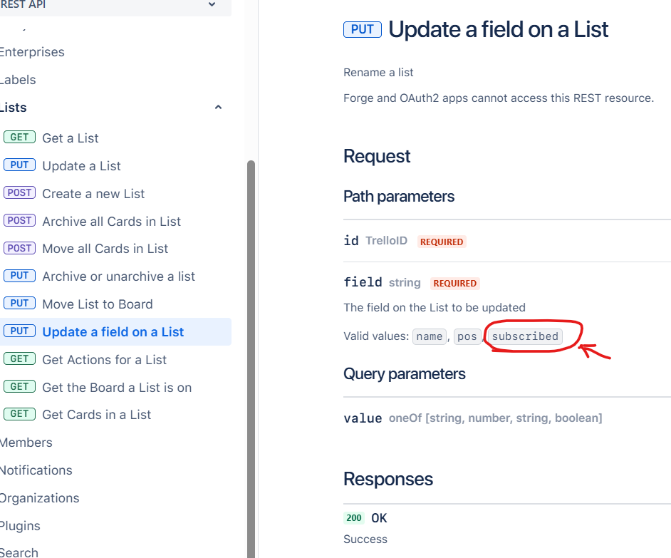

Hello @Rasmus Wulff Jensen ! Can I ask a question about API call "Update a field on a List".
Update a list
These Api call allows to update fields on the list. One of the option (fields) is 'subscribed'. But I can not see such an field on the list image.png
When I send 'subscribed' with value eather true or false I am getting back 200 status code. But when I try to retrive back such a field I get null. Then I try to send any word instead of valued field and I get 200 status code back.
So it looks that theris no field 'subscribed' and API did not show any error message about wrong query parameters that is being send to server while use API call 'Update a field on a list'
But maybe I dont understand something.

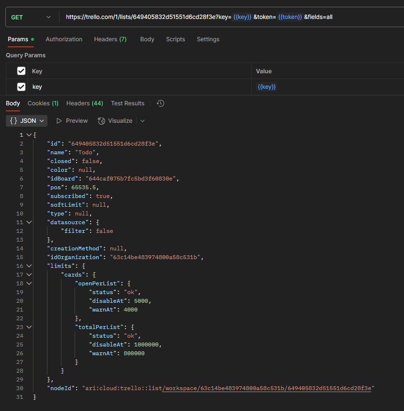

Rasmus Wulff Jensen
June 15, 2025
@Dmitrii
Here is how you subscribe:
PUT
https://trello.com/1/lists/{{listId}}?key=&token={{token}}&subscribed=true
Here is how you get the data back:
GET
https://trello.com/1/lists/{{listid}}?key=&token={{token}}&fields=id,name,subscribed
or
https://trello.com/1/lists/{{listid}}?key=&token={{token}}&fields=all
(to see everything)
In general, "&fields=all" will reveal tons of extra fields on almost any Trello object, so a good way to find/debug

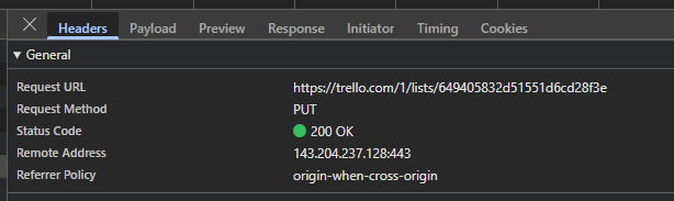

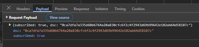

Another good way is to use Browser Tools on Trello.com, as they (Trello) are internally also using this API:
