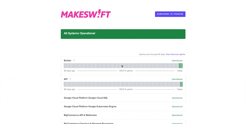

I've noticed on our status page that the "Subscribe to updates" button starts too high and then shifts down to be centered with the logo.
https://status.makeswift.com

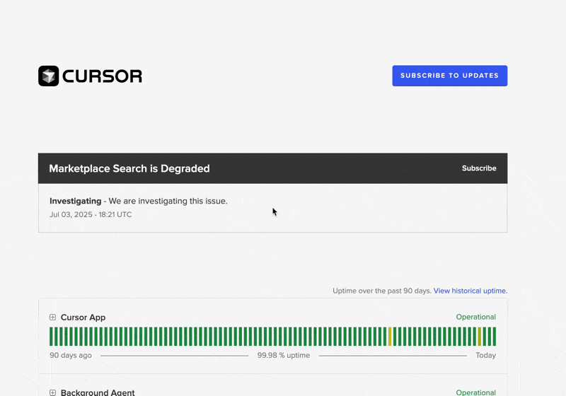

I don't think this is unique to our status page. I think it is an Atlassian status page problem. I noticed the same thing on Cursor's status page:
https://status.cursor.com/

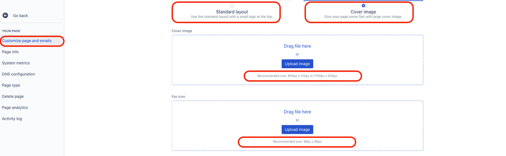

I understand you've observed a small change with the 'Subscribe to updates' button on your Statuspage. I have checked the page details, and it appears that the background rendering, along with image adjustments, might be causing this issue. Could you please try reuploading the images using the recommended size options? Different image sizes are available depending on the page layout, so you can adjust the images accordingly before uploading them as Statuspage logos.
Try the recommended approach and let us know if you are still noticing any issues. You can reach out to us at https://support.atlassian.com/contact for more instance-specific help required after the recommended tests you have performed.

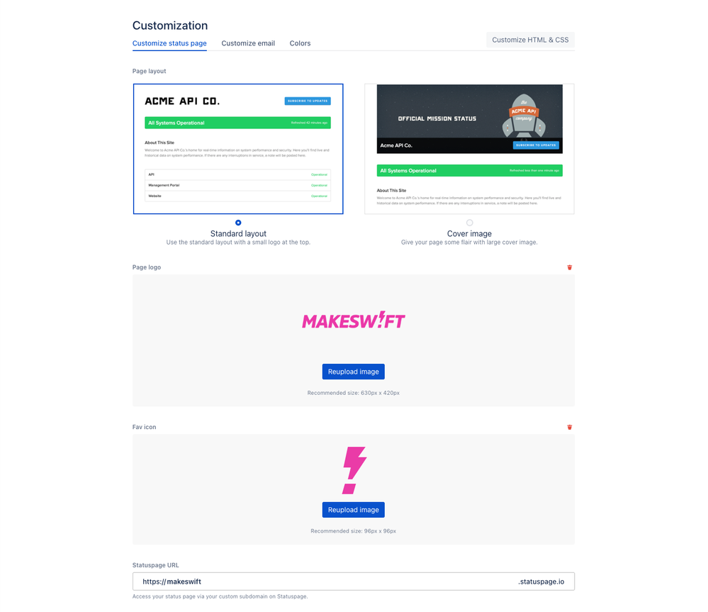

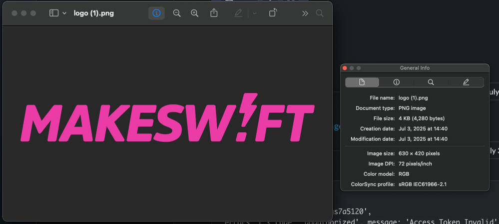

I noticed this, and that's why I'm a bit confused:
Both of my images are the recommended sizes
