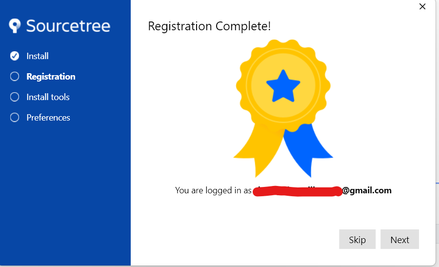

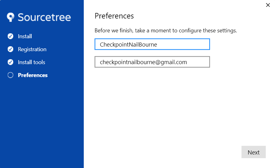

1. I run 'SourceTreeSetup-3.4.14.exe'
2. I get the registration page and I choose Bitbucket.
3. This fires off the edge browser with a blank page and a url like "localhost:34106/?code={uniquecode}&state=authenticated"
4. Don't know what to do so just close the browser and return to the install program.

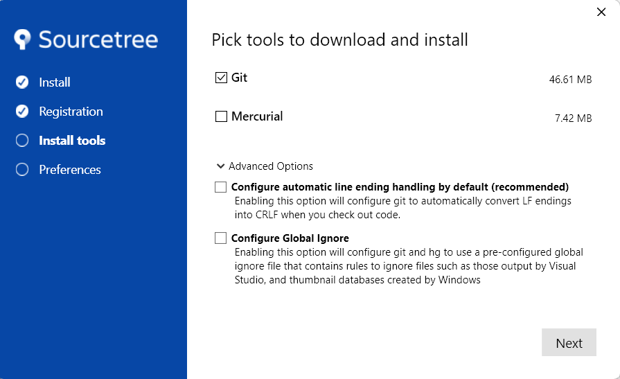

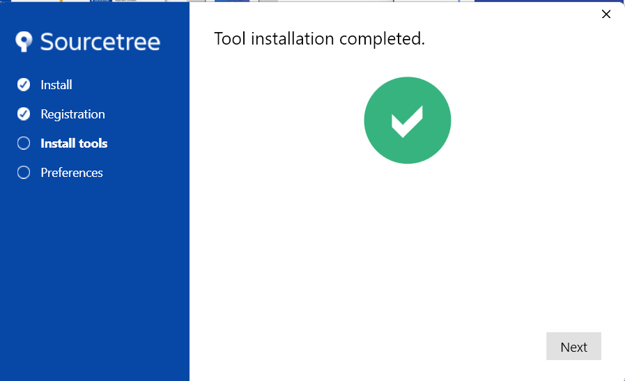

8.

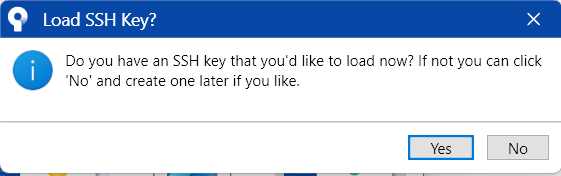

No

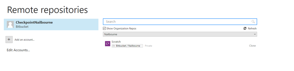

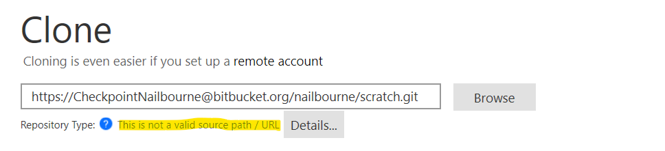

11. I click on Clone
It prompts me for my login credentials which I give.

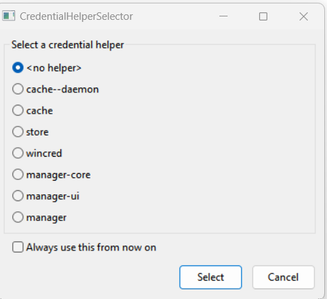

12. The following dialogue comes up 3 times
I then try and clone and I get the following.
I get this error. The path is correct and so is my password. Whatever I try I cannot clone.

ERROR [2023-08-14 20:13:53,864] [1] [SourceTree.ViewModel.CloneNewDialogViewModel] [Log] - Could not determine repository from: 'https://CheckpointNailbourne@bitbucket.org/nailbourne/scratch.git', output was:
ERROR [2023-08-14 20:13:53,864] [1] [SourceTree.ViewModel.CloneNewDialogViewModel] [Log] - Command: git -c diff.mnemonicprefix=false -c core.quotepath=false --no-optional-locks ls-remote https://CheckpointNailbourne@bitbucket.org/nailbourne/scratch.git
Output:
Error: remote: Invalid credentials
fatal: Authentication failed for 'https://bitbucket.org/nailbourne/scratch.git/'
ERROR [2023-08-14 20:18:07,349] [1] [SourceTree.ViewModel.CloneNewDialogViewModel] [Log] - Could not determine repository from: 'https://CheckpointNailbourne@bitbucket.org/nailbourne/scratch.git', output was:
ERROR [2023-08-14 20:18:07,349] [1] [SourceTree.ViewModel.CloneNewDialogViewModel] [Log] - Command: git -c diff.mnemonicprefix=false -c core.quotepath=false --no-optional-locks ls-remote https://CheckpointNailbourne@bitbucket.org/nailbourne/scratch.git
Output:

I would split this into two separate problems, since the registration loop and the clone failure have different causes.
For the registration loop, I would check whether Sourcetree can actually write its account file. After you register, look in %LOCALAPPDATA%\Atlassian\SourceTree for accounts.json. If it never appears, Sourcetree is failing to persist the account, and it will show you registration again on every start.
For the clone error, that is unrelated. Bitbucket Cloud rejects your Atlassian account password over HTTPS. You need to create an app password at Bitbucket > Personal settings > App passwords with Repository read, and use your Bitbucket username, not your email, with that app password as the password. Also clear any old bitbucket.org entries in Windows Credential Manager first.
