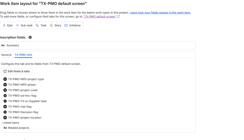

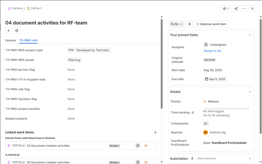

I've created a custom fiels called TX-PMO-project-code and added it to a screen called TX-PMO-default screen. This field is not visible in work items, my other custom fields do appear.

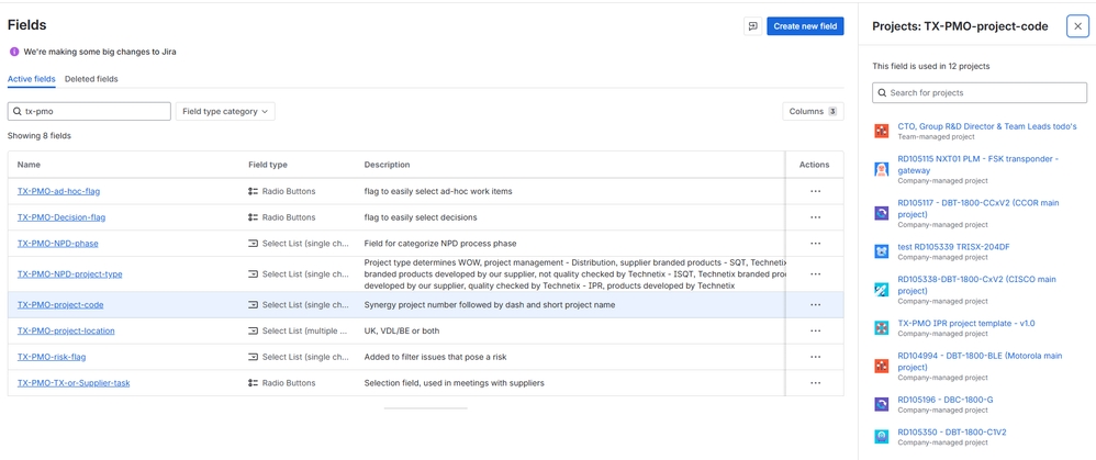

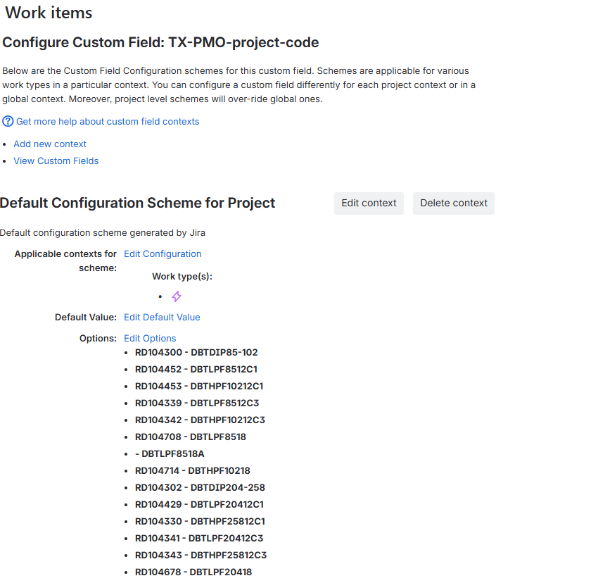

Hi Hans, thanks for replying. This is te configuration of the custom field:

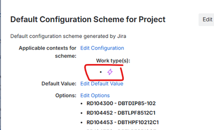

I see the problem :) As I mentioned, issues like this are 99/100 times caused by the context configuration. In the screenshot you provided, I can see that the field is only configured to show for Epics.

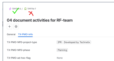

In the screenshot you shared in your original post, you were showing TPPTN-7, which is a Story. If you test it on TPPTN-6 (the epic), you should see the field there without issues.

To solve this, you can do one of two things:
1) In the last screenshot you shared, click 'Edit configuration' en add the Story work type to the context.
2) My advice: In the last screenshot you shared, click 'Edit configuration' en remove the restriction for Epic (so that the field will show for all work types). Generally, you should try to refrain from limiting field visibility for work types, as you'll always run into these kind of issues in the future (long after you've forgotten that you configured it this way).
