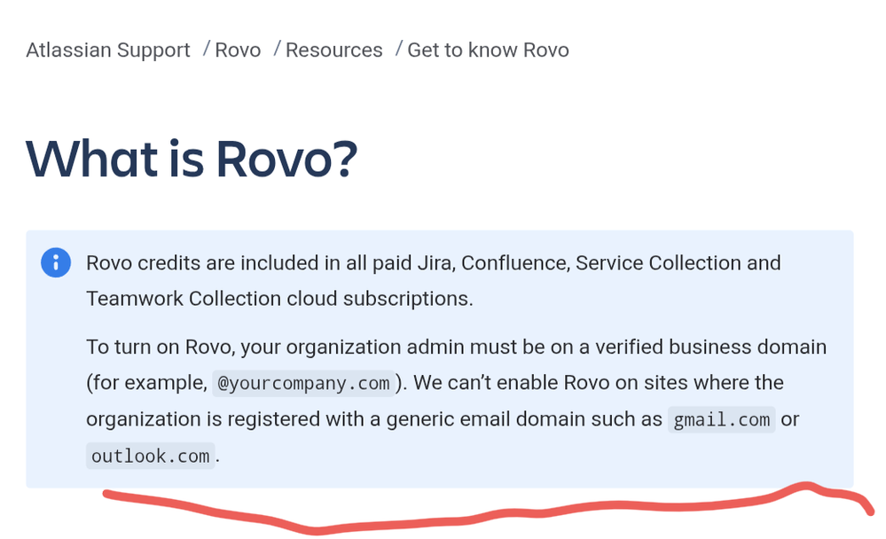

The personal email origin is likely the root cause here.
To activate Rovo, an Atlassian Org Admin must log in using a verified business domain, as generic domains like Gmail are not accepted.
Apps → Connectors is missing, suggesting an entitlement or domain issue, not a connector bug. Verify in admin.atlassian.com that your company domain is Verified, your site has a paid plan, and the site is enabled under Rovo → Rovo access.
If those all check out and the menu still won't appear, hold off on recreating the org and reach out directly to Atlassian Support with your Org ID and screenshots, they'll likely need to fix the provisioning on the backend.

@Paul Barrett welcome to the community. Since Apps → Connectors is missing entirely, this looks more like an org/site provisioning or eligibility issue than a specific connector problem. Atlassian requires an Org Admin on a verified business domain to enable Rovo and manage Teamwork Graph connectors. Verify the domain, Rovo access, and paid site first. If those are correct and Connectors is still missing, I’d open an Atlassian Support case rather than recreate the org.
