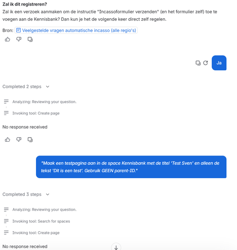

Whenever the agent attempts a write action (either create-page or edit-page):
  1. The "Please review" card appears correctly.
  2. The user clicks "Confirm selected".
  3. The UI shows "Completed 2 steps" but then displays "No response received".
  4. Crucially: No page is created or updated in Confluence. The action fails silently in the backend despite the "Completed" status in the chat.

Regarding your suggestion: I have just performed a side-by-side test to isolate the issue, and the results are very specific:
  1. Hierarchy Test: I removed the Parent Page ID from the Agent's instructions as you suggested.
  2. Desktop vs. App:
    • Rovo Desktop/Studio: The Agent successfully created the page 'anywhere' in the Space. The action completed without errors.
    • Rovo Mobile App: Using the exact same Agent and the exact same chat session, the action consistently fails with a "No response received" error, and no page is created in Confluence.
This confirms that while the hierarchy bug you mentioned is a factor, there is also a significant runtime/UI timeout issue specific to the Rovo Mobile App that does not occur on Desktop.
