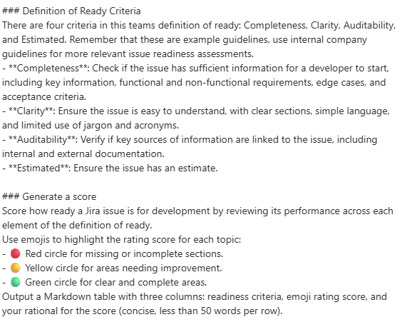

I love what @Dr Valeri Colon _Connect Centric_ has suggested here in terms of "just read the instructions". That's the best way to understand what the agent is trying to do. Valeri was kind about "evolving logic". I would agree it comes down to poor agent instructions. Because that's an out-of-the-box agent, I could go so far to say it's a bug. That said, I typically explain those agents as "off the rack" and they should always be tailored to suit a customer's needs. They were written with a mix of intent, including helping others to learn how to write agent instructions. For this particular case, I don't think "auditability" is a good criterion because it doesn't line up with the practices I've learned about writing good user stories. Also, I'd call that "traceability" but maybe I'm old-school.
Despite my disagreement, let's look closer to understand how we can fix it. There's only 1 line associated with Auditability, "Verify if key sources of information are linked to the issue, including internal and external documentation." As a human, I don't think I could score that concept either. What's a key source? Is the fact of a link sufficient when some links might not be the "source" of an issue? In contrast, the other "soft concepts" like completeness and clarity have examples that give the LLM enough "clues" that it can form an opinion about good vs bad.
How can we fix it? I'd try one or more of the following.
  • Explain the concept of auditability. Defining terms can help when there are many possible meanings, or our meaning is unique to our company or domain.
  • Provide examples, either good or bad help. Both are better.
  • Provide a step-by-step logic for assessment. In this case, I'd tune the instructions in "Generate Score" so they are less "open to interpretation".
I've been collecting some principles and practices for agent instructions (ie prompt engineering) in a GitHub repo. Feel free to use as a jumping off point:
https://github.com/ibuchanan/forge-rovo-metaprompting/tree/main/prompts
There's also a technique you could try based on the table you built. Like what I'm working on above, it's "meta prompting" so you don't have to use Rovo to do this:
I'm trying to improve this prompt:
[agent instructions]
This is the result I got:
[actual agent result]
This is the result I expected:
[expected agent result]
How can I improve the prompt so it generates a result more like what I want?
Sometimes I do that across Rovo and a couple other LLMs as a kind of "set-based design" so I can combine the best parts of each.

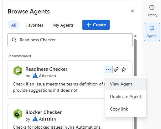

You can view the agent’s instructions by clicking on the three dots (…) next to the agent name, then "View Agent". If you’d like more control, you can also duplicate the agent and add your own custom instructions—for example, defining what “readiness” looks like in your specific context. Then you can test it and adjust as needed.
