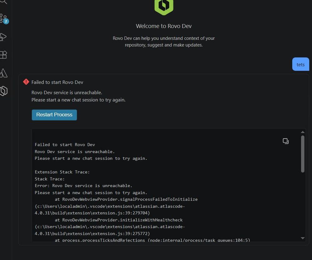

after I enter my new API token , i can not start RovoDev more , I use VS code
I get  those errors
Failed to start Rovo Dev Rovo Dev service is unreachable. Please start a new chat session to try again. Extension Stack Trace: Stack Trace: Error: Rovo Dev service is unreachable. Please start a new chat session to try again. at RovoDevWebviewProvider.signalProcessFailedToInitialize (c:\Users\localadmin\.vscode\extensions\atlassian.atlascode-4.0.31\build\extension\extension.js:39:279704) at RovoDevWebviewProvider.initializeWithHealthcheck (c:\Users\localadmin\.vscode\extensions\atlassian.atlascode-4.0.31\build\extension\extension.js:39:275772) at process.processTicksAndRejections (node:internal/process/task_queues:104:5) at async RovoDevWebviewProvider.handleProcessStateChanged (c:\Users\localadmin\.vscode\extensions\atlassian.atlascode-4.0.31\build\extension\extension.js:39:273723) at async mp.value (c:\Users\localadmin\.vscode\extensions\atlassian.atlascode-4.0.31\build\extension\extension.js:39:256945) Rovo Dev Logs: 2026-07-27 19:13:36.668 | 13316 (13316) | DEBUG | Using endpoint: https://api.atlassian.com/rovodev/v3/sites 2026-07-27 19:13:36.668 | 13316 (13316) | DEBUG | Making request to get sites from URL: https://api.atlassian.com/rovodev/v3/sites 2026-07-28 07:13:46.638 | 12736 (12736) | DEBUG | Using endpoint: https://api.atlassian.com/rovodev/v3/sites 2026-07-28 07:13:46.639 | 12736 (12736) | DEBUG | Making request to get sites from URL: https://api.atlassian.com/rovodev/v3/sites 2026-07-28 07:26:26.959 | 10740 (10740) | DEBUG | Using endpoint: https://api.atlassian.com/rovodev/v3/sites 2026-07-28 07:26:26.960 | 10740 (10740) | DEBUG | Making request to get sites from URL: https://api.atlassian.com/rovodev/v3/sites 2026-07-28 07:41:31.881 | 9800 (9800) | DEBUG | Using endpoint: https://api.atlassian.com/rovodev/v3/sites 2026-07-28 07:41:31.882 | 9800 (9800) | DEBUG | Making request to get sites from URL: https://api.atlassian.com/rovodev/v3/sites 2026-07-28 07:57:30.201 | 1676 (1676) | DEBUG | Using endpoint: https://api.atlassian.com/rovodev/v3/sites 2026-07-28 07:57:30.201 | 1676 (1676) | DEBUG | Making request to get sites from URL: https://api.atlassian.com/rovodev/v3/sites

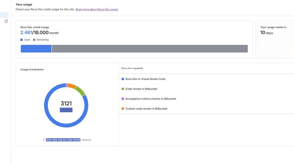

But I checked my usage, I have 18000 credits every month and I only used 3000

but I checked I have 18000 credits for one month Screenshot 2026-07-28 084538.jpg

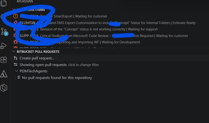

Hi, @Viswanathan Ramachandran thanks, I have created API token, and it works to show jira item, but rovo dev is unreachableScreenshot 2026-07-28 105440.jpgScreenshot 2026-07-28 105535.jpg

Hi @zhiru cao
Status page looks alright. So its not wider incident issue.
It looks VS Code can’t reach it. The extension itself loaded, but its supporting process is unreachable.
Can you check ?
  • VPN, proxy, firewall, or corporate network blocking it
  • Expired/invalid Atlassian sign-in session
  • The Rovo Dev extension process crashed or got stuck after an update
  • A corrupted extension installation/cache
Try Restart Process, then start a new Rovo chat. If it persists, reload VS Code, sign out/in to Atlassian, and check whether your network/VPN permits Rovo Dev connections.
