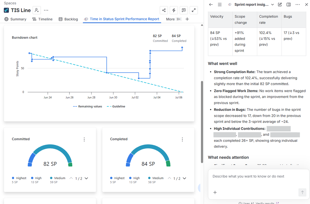

August 26, 2026
Hi @Anuj Batta
If resolving everything from a team label becomes difficult with a custom Rovo setup, there is also a ready-made option you could try.
Time in Status by SaaSJet includes a Sprint Report Insights Rovo agent that automatically generates a retrospective based on sprint data — completion rate, velocity, scope changes, workload, work item distribution, key observations, and recommendations.
The main difference from your use case is that it works from a selected board and sprint, rather than from a team label.
So it may not replace the exact flow you described, but it could be useful if you’re looking for an already-built retrospective agent instead of creating the whole analysis from scratch.
