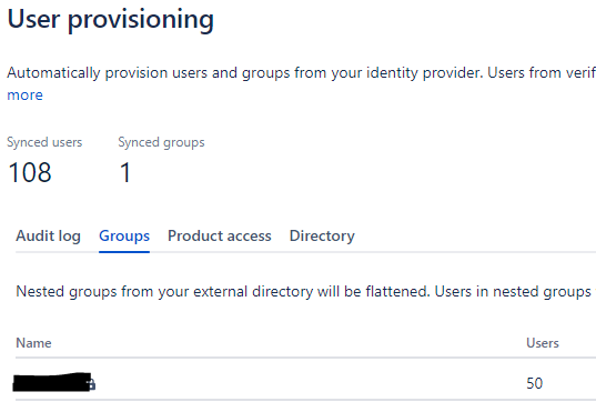

We are using Atlassian Access to sync our users from Azure AD to Jira by specifying the group "ALLUSERS". The group has 108 users. All the users seem to be synced OK but the users in the group is shown to be only 50 (and not 108). Any reason for this and how to fix it? As we need to assign access permission based on this group.

We tried to re-sync all the users/groups again by check "Clear current state and synchronization" in Azure AD side, and now all the users are assigned to the group correctly.

In Addition: The users are linked to Jira Service Desk and only the 50 users are shown there.
