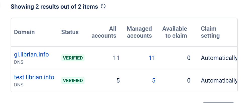

To verify if there is another organization with same domain verified, please check:
All Accounts = Managed Accounts + Available to Claim, as image above.
If yes all Atlassian Account with this domaim were available to claim and the domain is verified only in your organization.
Also, could be a difference between the number of the Atlassian account and Entra ID accounts.
For Atlassian, only the emails already used in Atlassian products have an ID and became an Atlassian account.
So, after invited or provisioned,  new emails from Entra ID in Atlassian organization, these accounts will be became an Atlassian Account.
If you found a difference between All Accounts and Managed Accounts + Available to Claim, you have a domain verified in another organization.

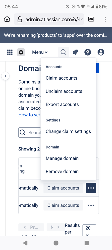

To check it you could export the accounts. In the line of domain configuration, there is 3 dots, and an option to export accounts.
To solve it,you have 2 options:
Share domain with another organization or You can try disable the domain Atlassian verification code in Domain provider or identify the another organization and delete the domain configuration.
