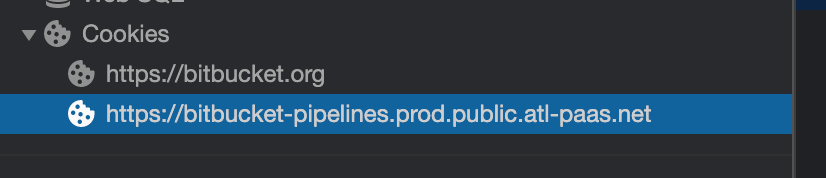

2-) Clear the bitbucket.org Cookies (This was necessary because the current cookies corresponds to the main account logged):

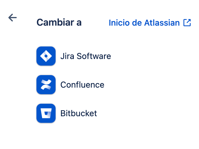

3-) Click on the Menu + Bitbucket:
