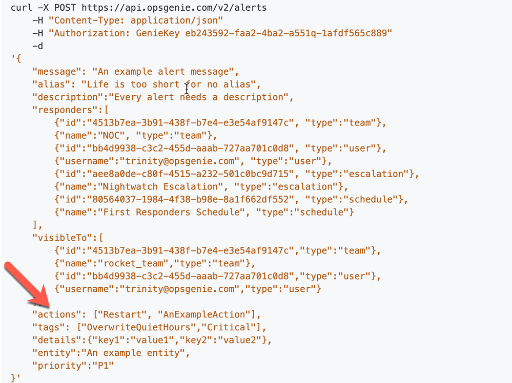

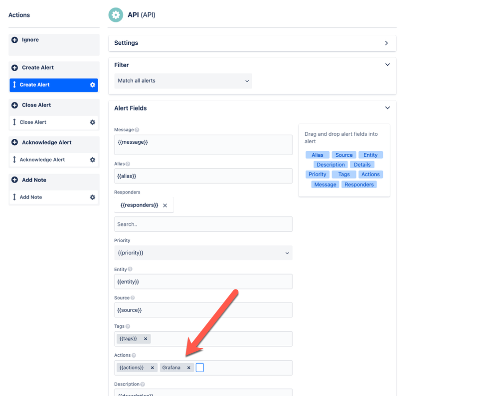

The first step is to add the custom action to the alerts (i.e. add the "Grafana" action to your alerts that are created in Opsgenie). This doc goes over how you can do this.
There are a few ways you can have this custom action be added to the alert. Since you are using the Alert API to create alerts, you could pass in the "Grafana" action in the Actions field of the payload you are sending to Create Alerts, so that the action would be added to the alert.
Alternatively, you could edit the API integration in Opsgenie, and add the "Grafana" action to the Actions field in the integration, so it will add the "Grafana" actions to alerts created through that integration.

Hi @yariv ,
So you're trying to add the actions to alerts via API? If so - you can just add the actions in the "Actions" field in the payload you are sending to create alerts as shown in the example on the Create Alert API request.
