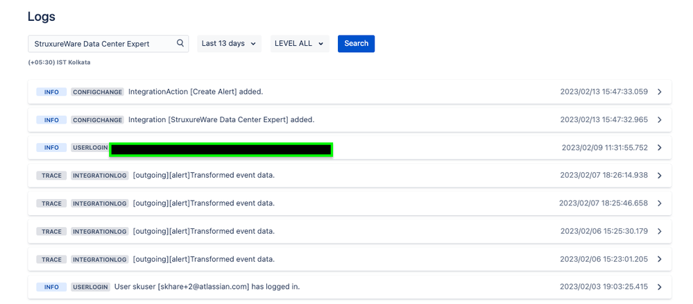

Once this is correctly configured, please trigger a new alert from StruxureWare Data Center Expert and navigate to Settings > Debug > Logs in Opsgenie to search with the Integration name as in the below example screenshot:Screenshot 2023-02-13 at 3.48.08 PM.png
With the above search, you can check all the incoming alerts that were triggered from StruxureWare Data Center Expert's end to verify if the integration was set up correctly and if the alerts are coming in as expected.
