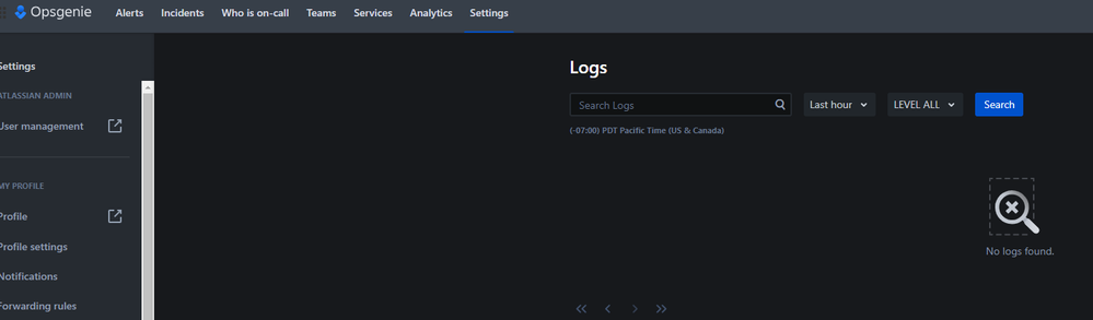

mike krauss
August 28, 2023
The integration is already setup in OpsGenie. I checked the logs section after I tried to test the alert in Grafana and there is nothing in the OpsGenie log.Screenshot 2023-08-28 155158.pngScreenshot 2023-08-28 155316.png
John M
August 28, 2023
@mike krauss Can you please open a support ticket so we can take a look at your account configuration?
