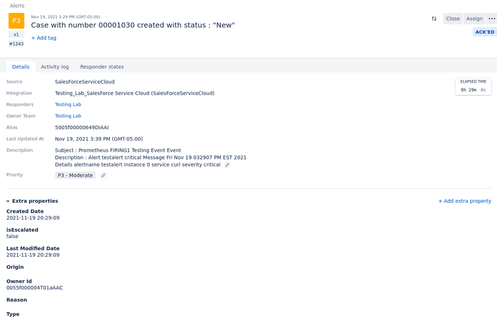

What I am Seeing:
New Opsgenie Alert -> Creates -> New Salesforce Case -> Creates -> New Different Opsgenie Alert
New Salesforce Case -> Creates -> New Opsgenie Alert

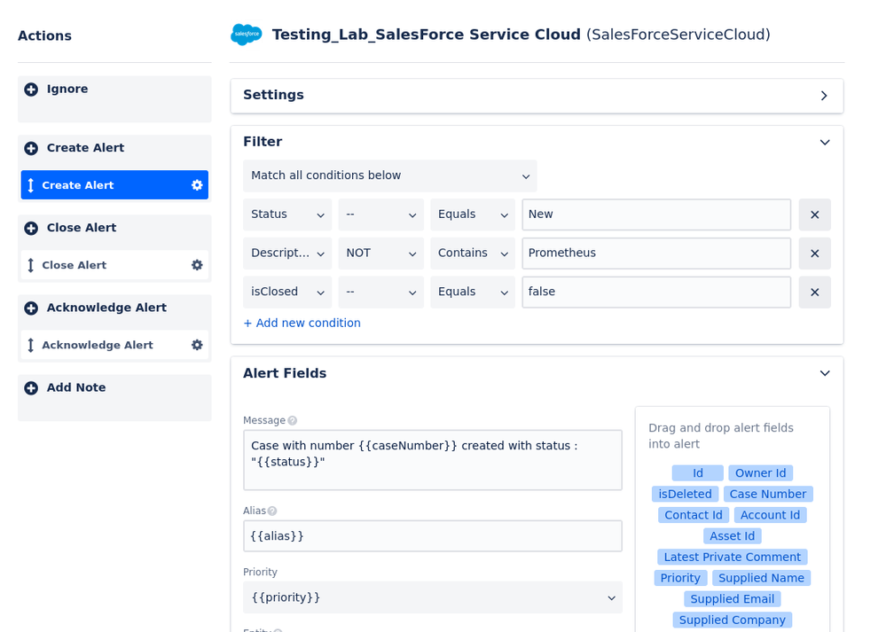

I did try to apply a filter to cont create alerts from Salesforce cases container the word Prometheus as most if not all alerts will be generated from Prometheus but it does not seem to work. That is the only change made from the default configuration.

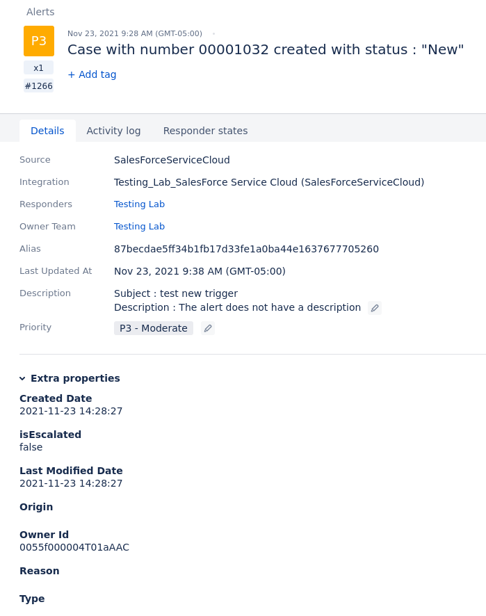

Hi Connor,

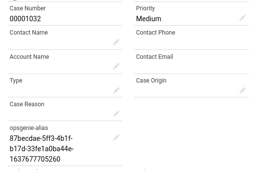

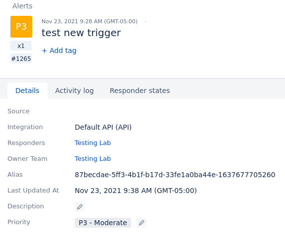

Thanks for the response it looks like salesforce is now improperly passing the opsgenie, it looks like the dashes (-) are being dropped somewhere when the echo happens
Order of what I am seeing

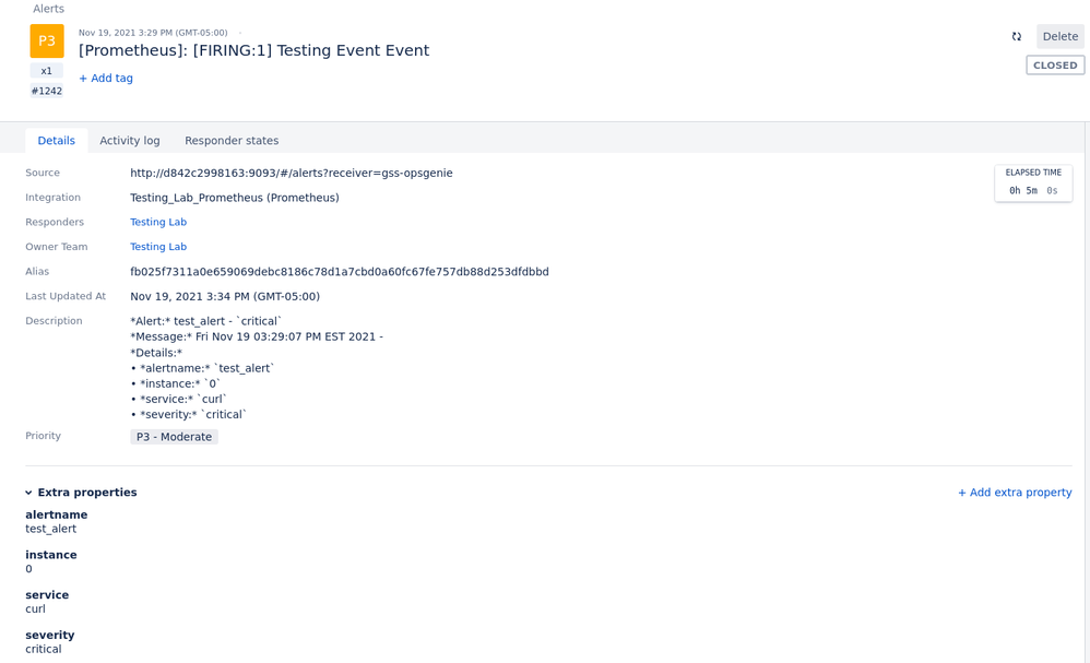

Initial Opsgenie ticket:

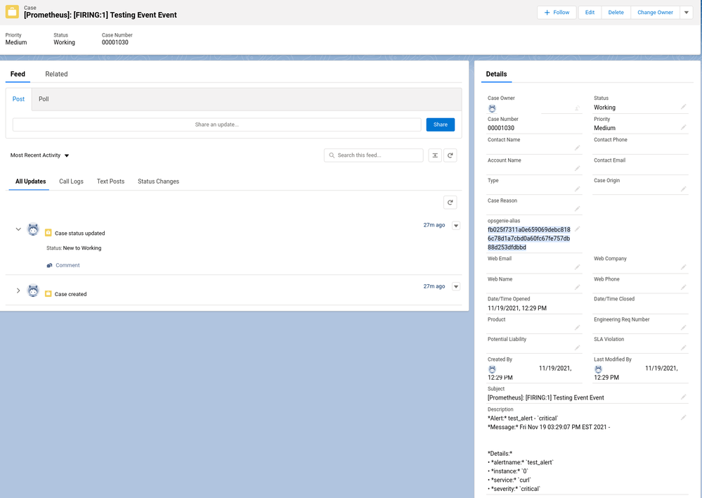

Salesforce Case Created:
Opsgenie Echoed Ticket:

Hi Connor,
I found the issue that is causing the the drop dashes it is within the opsgenieClass.apxc that you provide, basically is filtering out all characters that are not alphanumeric or a space so I replaced
[^a-zA-Z0-9\\s]
with
[^a-zA-Z0-9\\s\\-]
at this line and it is now passing the opsgenie_alias propperly
