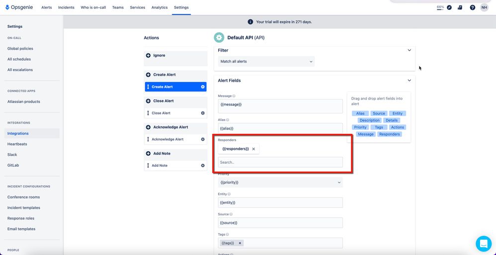

The default API cannot be assigned to a team like you mentioned, but a responser (such as team) can be added into the responder field of the integration's create alert action:
This typically is not recommended, but I guess it depends on the use case. The responders added would be notified of the alerts created through the default API - which in turn would notify them of the alert being closed as well. But that doesn't necessarily mean they'd be notified if the alert was closed through the default API - and created through another integration.
