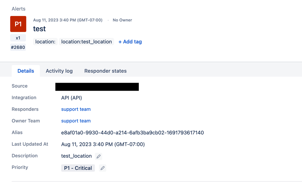

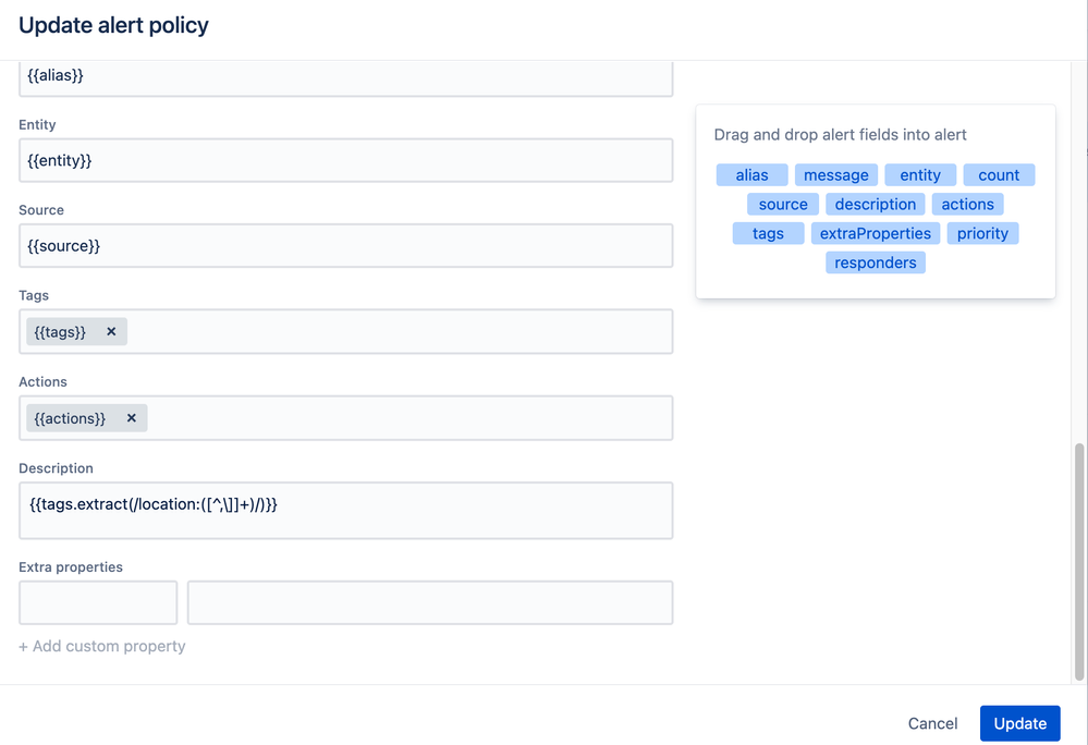

John M
August 11, 2023
Since your regex uses '+' it should only match tags that have at least one character after the semicolon - so 'location:' should not show up. When I tested this only the tag with a value after the semicolon was added to the description:
As for the case, I don't believe there is any workaround for that; I believe the system just translates all processed characters to lower case
