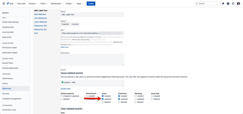

In JSM / the webhook, make sure that Issue Update checkbox is selected:
If this is selected, then the close actions are most likely sending to Opsgenie, but they are not matching what is configured in the Close Alert action of the integration.

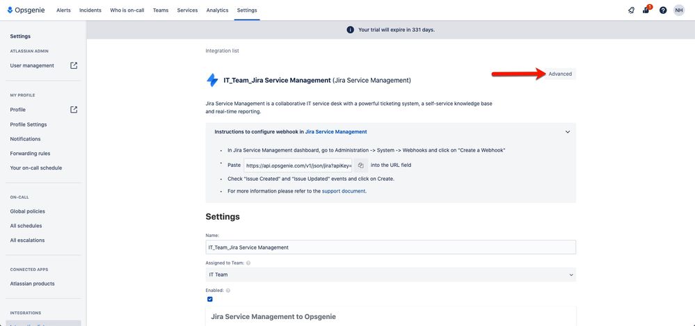

This can be reviewed in the Advanced tab of the JSM integration:

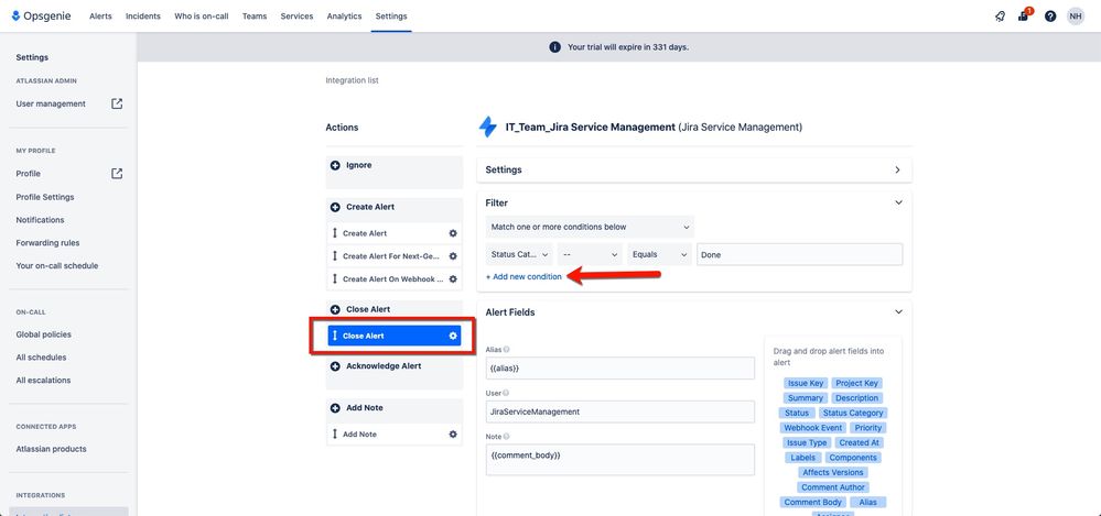

Here is where you can configure what JSM requests will close an alert. By default, the only condition Opsgenie looks for is for is: Status Category = Done.
You may need to edit this condition, or add additional ones that filter on what states the issue transitions into:

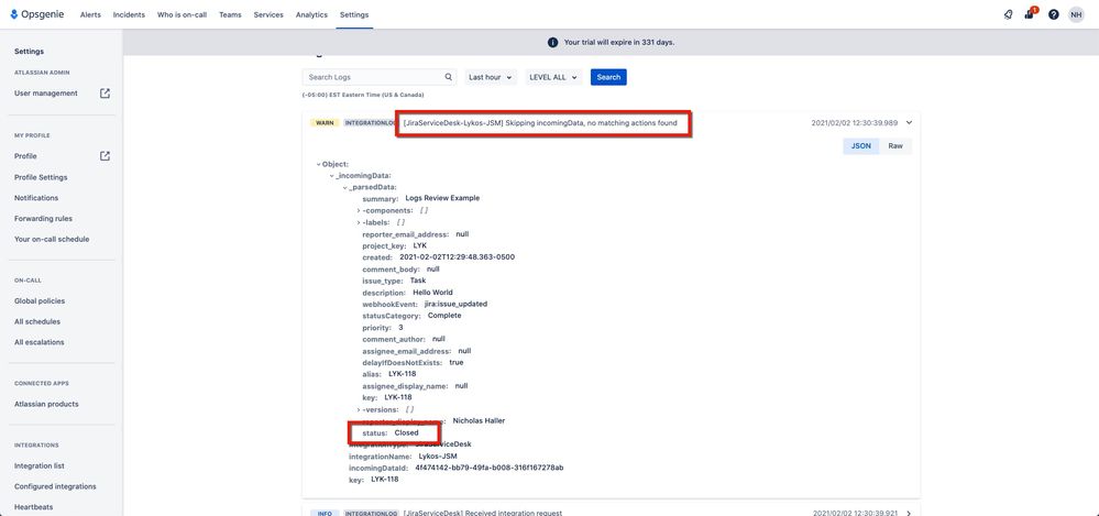

You can always troubleshoot what data is being parsed in these requests as well under the Settings Tab >> Logs Tab. If the request is being receive, an error log typically appears explaining there isn't a matching condition. You can review the log to determine which fields the integration's filter / conditions need to meet for the alert to close when the issue is transitioned:

thanks for quick reply, but I'm unable to find Advanced tab of the JSM integration.
Maybe not all Opsgenie versions allow Advanced configuration?
Nick Haller
February 2, 2021
That's correct. The Advanced tab is only included in the Opsgenie Standard or Enterprise plans. Our plans map to JSM as such:
JSM Standard ~ Opsgenie Essentials (which is the plan I assume you are subscribed to if you do not see this tab)
JSM Premium ~ Opsgenie Enterprise
