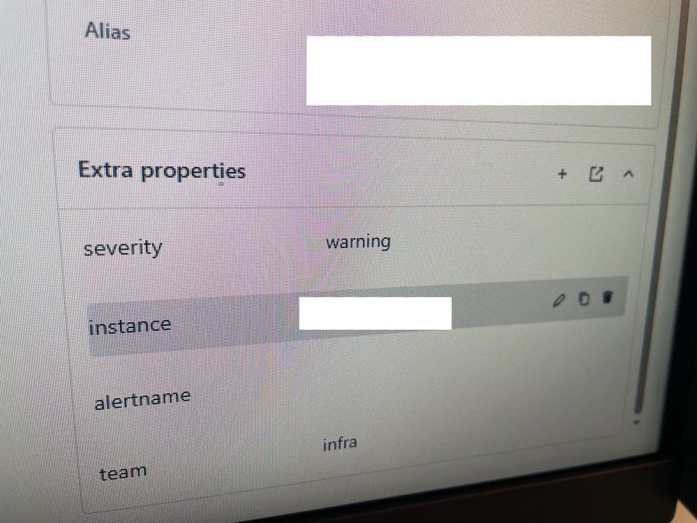

We receive the alerts and get them populated into Jira using Opsgenie in the following format as shown below.
[Prometheus]: [FIRING:1] <server> (WindowsServerCpuUsage warning infra)
Description
Windows Server CPU Usage (instance <server>)
The extra properties only contain the following values.
Extra properties
severity     warning
instance     <server>
alertname
team          infra
Can you please advise if the additional fields (such as Description, environment and Summary) need to be also configured in Administration part of the UI and how to get them populated under the "Extra properties" section?

Could it be related to notification policies in the Teams that need to be set up behind the scenes? As the default Properties are visible there in the Prometheus alert ingested into Opsgenie, in JSM.
At this point, the only question is how to get the other additional fields preserved and make them available in all the alerts if they also meet the criteria of the Prometheus alert.
Please find the screenshots attached if this could be helpful.

Eugene Sheyko
May 20, 2025
Thank you for your response, I believe only user with the Administrator would be able to see the Teams > Integrations functionality? We will check this and will confirm soon.
