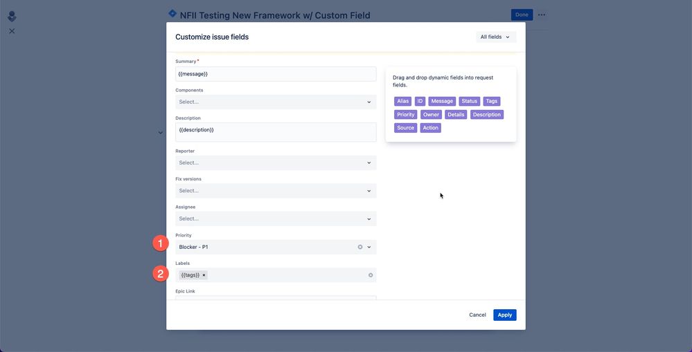

You can continue to use OEC after the migration. Although OEC is primarily used for on-prem instances, we do see customers using it with their cloud instances to map Opsgenie alert fields to specific Jira / JSM issue fields.
We also recently released a new Jira and JSM integration framework that can map these fields - including some custom fields - out of the box without using OEC: https://community.atlassian.com/t5/Opsgenie-articles/NEW-Jira-Software-and-Jira-Service-Management-Opsgenie/ba-p/1952529
