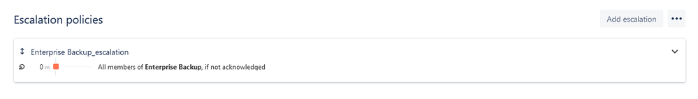

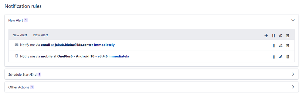

I have OpsGenie integrated with my check_mk monitoring. I receive alerts on the web page correctly, but I'm not getting any email or app notification while all seems to be set up correctly. Team is defined with one member, escalation is set to all team members at 0m if alert is not acknowledged. I have attached two screenshots showing the configuration.

Are the alerts setting the responder correctly to the team you are a part of? A helpful screenshot would be of the alert's activity log, showing the steps it takes to (not) notify you.
I think you may be referring to this:
Jul 29 5:43 PM system System
Skipping Create alert notification policies for alert because it doesn't have an owner team.
Looks like I missed something in configuration.
