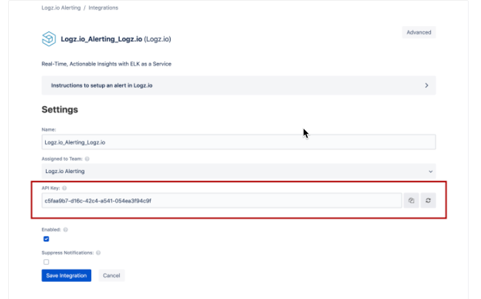

This is an authentication error. Could you share if your Opsgenie account is in EU domain? When you login to Opsgenie, is the url https://app.opsgenie.com or https://app.eu.opsgenie.com ?
If it is EU, you will need to change to  create a custom notification endpoint in Logz.io with endpoint = https://api.eu.opsgenie.com/v1/json/logzio?apiKey=your-integration-key
your-integration-key is the apiKey from your logz.io integration in Opsgenie
e.g.
