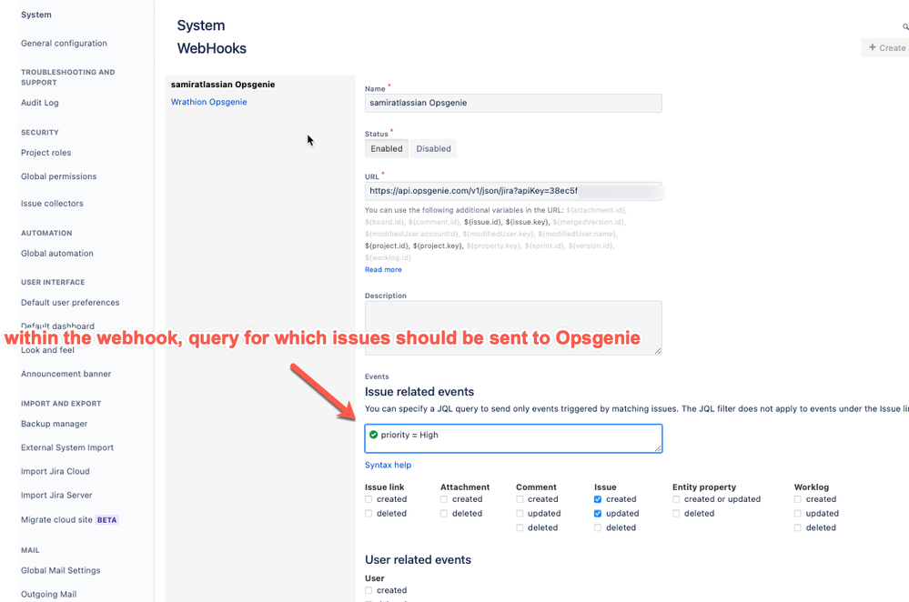

Could you clarify which integration you are using between Opsgenie and JSM? We have a few options now. The most common one involves configuring a webhook in JSM to send the issues to Opsgenie? If so - you have a couple of options for setting it up so that only JSM incidents with priority = P1 will create alerts in Opsgenie.
  1. In the webhook you created in JSM that sends incidents to Opsgenie, you can use JQL to to specify a query so that only incidents with priority = P1 are sent to Opsgenie2022-03-11_08-55-19.png

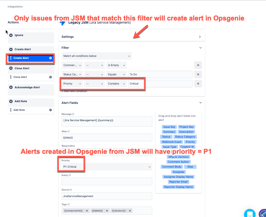

  2. Alternatively depending on your Opsgenie plan, if you have access to "Advanced" view of integrations, you can filter on the JSM integration in Opsgenie to specify which issues from JSM should create Opsgenie alerts2022-03-11_08-57-05.png
    You can also specify that the alerts created in Opsgenie from JSM should have priority = P1
