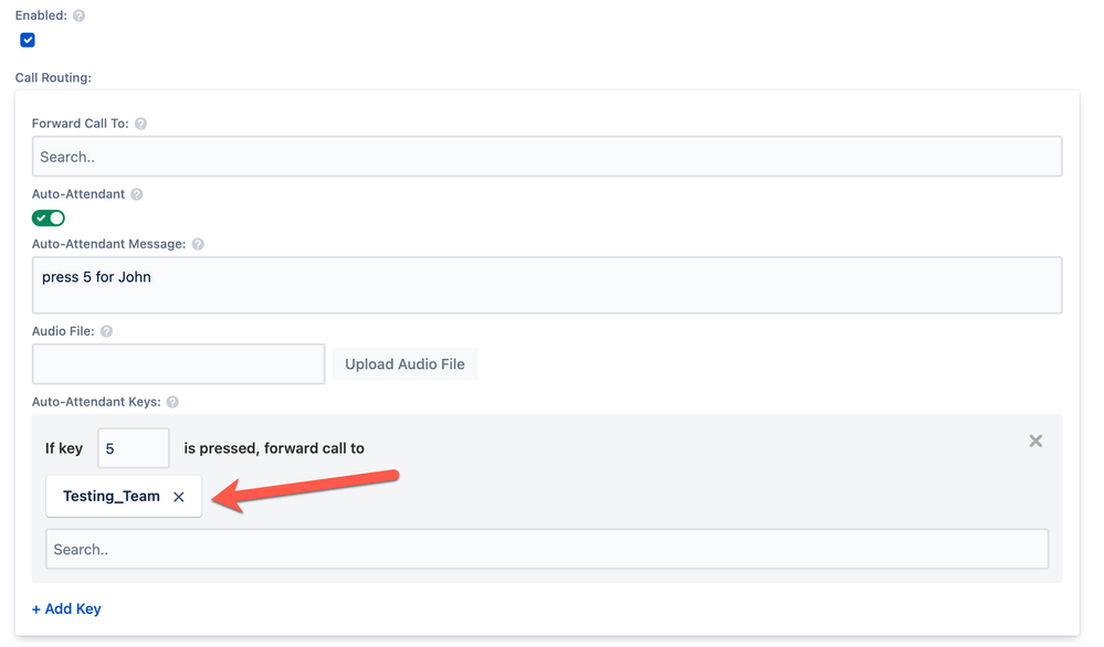

I am setting up an Incoming Call Integration and was hoping to use the automated attendant to present the calling with options.  The problem that I am having is that I can't seem to figure out how to alter the resulting alert that is created based on which option the caller selected.
The only filter fields I see as available are:
  • From
  • To
  • Body
  • Type
Is there any way to filter/find which menu option was selected?
John M
May 11, 2023
Hi @Jamie Remboldt (x. 6607) ,
Unfortunately, the only field that can be altered by the caller after the alert is created (which happens as soon as the call reached Opsgenie) is the 'Responders' field. That field can be updated after the alert is created, based on the caller's selection. 2023-05-11_10-56-57.png

Thank you!  Your response helped as I was using the auto attendant to forward the call to various teams, however I had inadvertently set the responders with the original alert so it didn't appear to be changing that.  By getting rid of the initial set and letting it go to the teams it is working well.  Thank you for the response/help!
