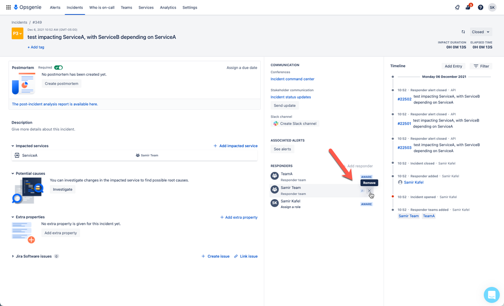

Hi @tmazzola !
You can remove a team as a responder from an incident by hovering over the team and clicking the "X"
However there is not a way to remove responders from alerts, this can only be done for incidents.
Thanks,
Samir

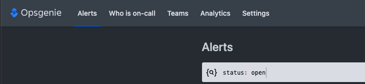

Thanks for the quick response. However, I don't have an Incidents tab to view; shouldn't this be included with the Owner Role?
Samir
December 16, 2021
It depends what plan you are on. You may be on an older Opsgenie plan that doesn't include Incidents. Incident Management is a whole separate feature set in Opsgenie.
