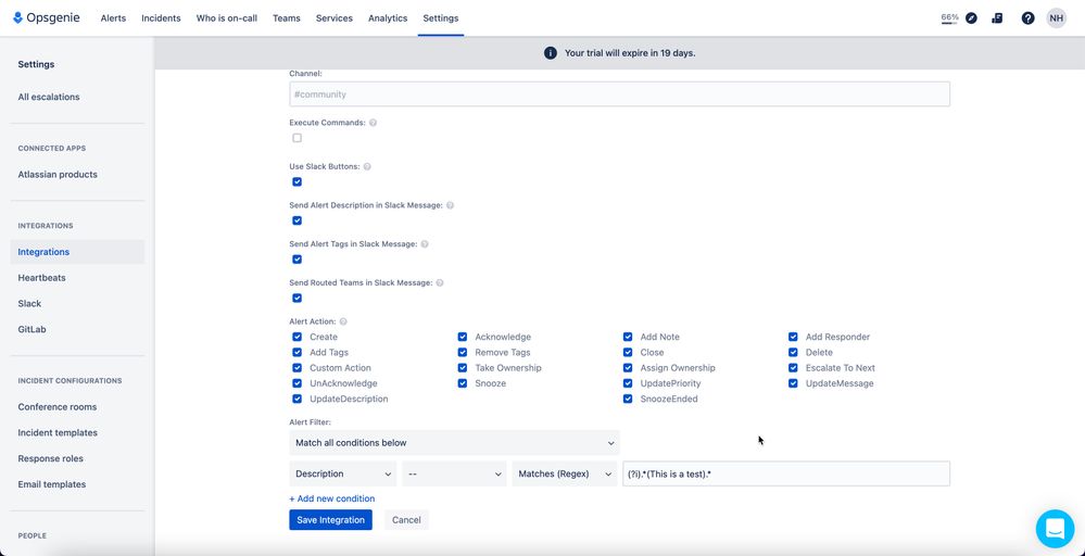

I'm having trouble filtering alerts that use the Slack integration. In this case I would only like alerts containing "This is a test" in their description field to use a Slack integration. Below is the filter I have applied to my Slack integration.

Hi @Issy Pearson ,
Maybe try filtering with regex using one of these values:
.*(This is a test).*
(?i).*(This is a test).*
The second would be case insensitive.
I typically use regex101 to validate if an expression will work.
Issy Pearson
December 11, 2022
@Nick Haller Yep that works thank you! I shall definitely have to brush up on my regex.

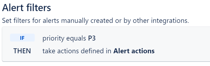

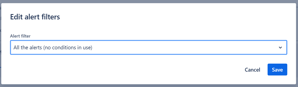

hi there i am also trying to create an alert filter for the integration between Jira & Slack.
I have read this article many time -> https://support.atlassian.com/jira-service-management-cloud/docs/work-with-alert-filters/
but somehow I wondering
1. if i set an alert like this one as blow - people might receive a lot of alert notification, however it is still logical, no?
2. couldnt understand why the following sentence dont work
- only aleart that with all the condition
-- priority equals P3 (same like in the article)
-- description contains alert
Do i make any mistake or do i unterstand it totally wrong?
