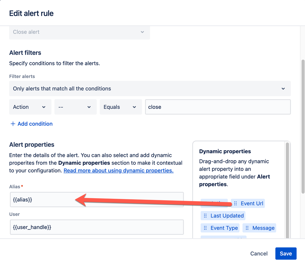

Here is a screenshot of the 'close' action in the Datadog integration, which must contain the same dynamic fields as the 'create' action:
