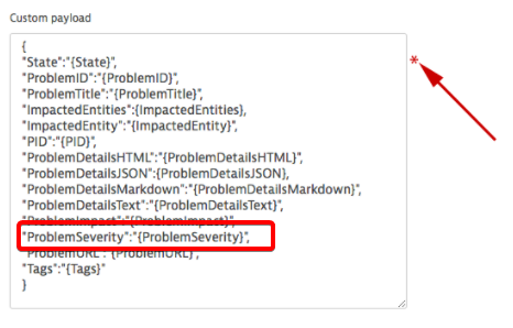

Based on the documentation, there is a custom pay load define as below :

Does it means that in Dynatrace payload the naming should match same name ?
Actually only ProblemId , State, ProblemDetailJson is able to be mapped corrrectly by opsgenie.

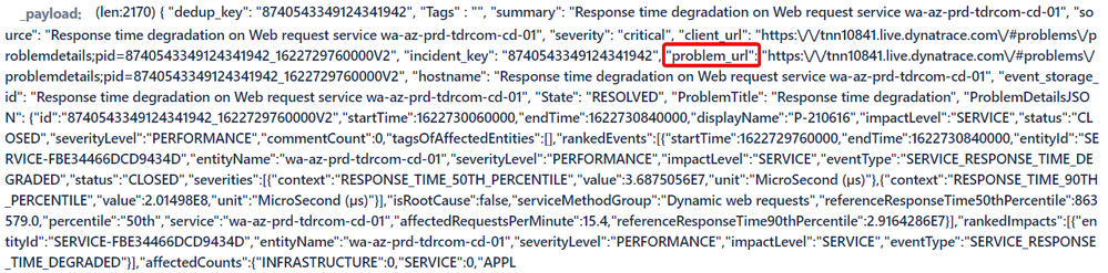

As you can see for exemple, the problem_url is present in payload with same name as in opsgenie default field, BUT it cannot be mapped ( confirm in logs)
Could you help me clarifiy what is the rule on fields naming inside dynatrace in order to get the field mapping working correctly and why some mapped some others not even with same name ?

Hello @connor mcguane , yes the screen shot is from the Osgeneni Log.
We try to understand what is the naming correspondance need to be done in order that field maping in opsgenie works
What I mean by field mapping in opsgeni is that opgenie is capable to populate incoming field to correct place holder of the integration.
As you can see in capture, the problem URL contains something but when I display the Problem_URL of the intergration in an Alert field, the field is null.

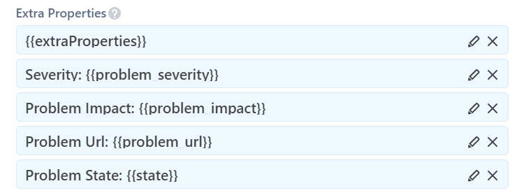

In my case, we are putting that field into Extra properties key-value pair.

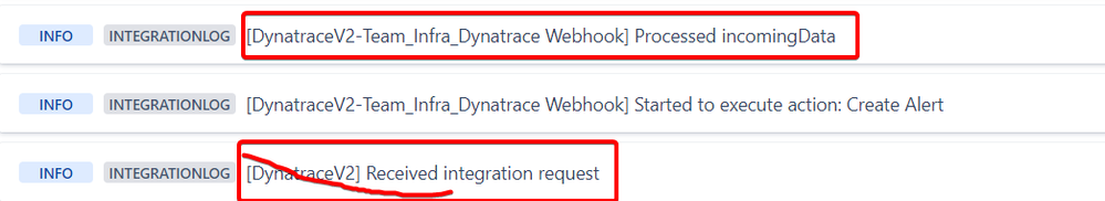

In the log incoming raw data from Dynatrace I can see them in
[DynatraceV2] Received integration request
Data processd by opgenie I can see them under Processed incomingData
If you open any of this entry, you will see there is a payload section you can expand, this is the section I screen shot where you can see incoming fields and mapped field in the 2 sections
This is what I have done, place all the field under extra property and all are null except STATE and Problem ID, and I do not know why.
Note : We are using the Dynatrace Web Hook integration

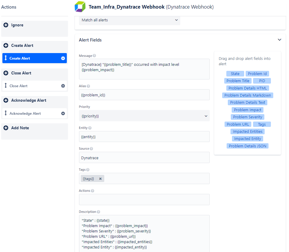

Can you post a screenshot of your Integration in Opsgenie for Dynatrace.  Thanks
serge calderara
June 4, 2021
@connor mcguane , here is
