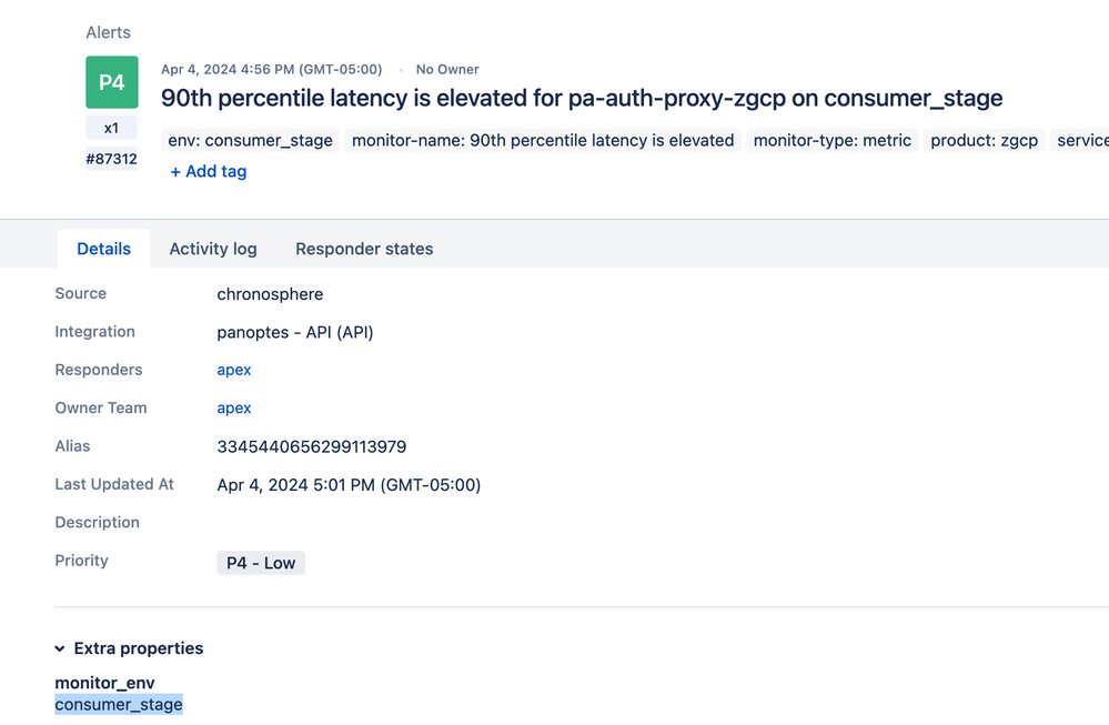

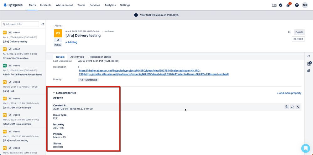

I tried to pull the individual alert as you mentioned.
One of the alert I picked has the extra properties in the  alert as shown below

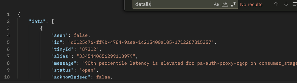

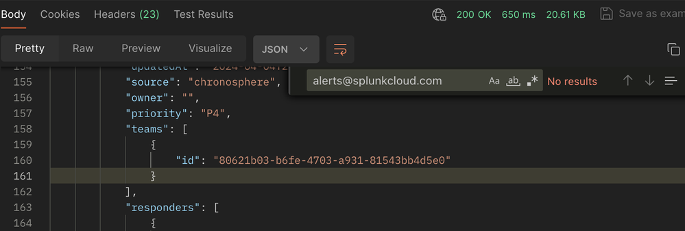

After getting the response in Postman I searched for the `alerts@splunkcloud.com` in Json body but it did not show it.
Even there is no details json attribute in the body

Hi @Rakesh Panchal ,
I can't say for certain those aren't the same alerts, but the top screenshot in Opsgenie shows the alert being a P3, while your Postman screenshot shows the alert being P4 - which leads me to believe those are not the same.

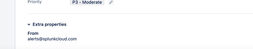

Sorry for the confusion @Nick Haller . Here is the better screenshots
Json response

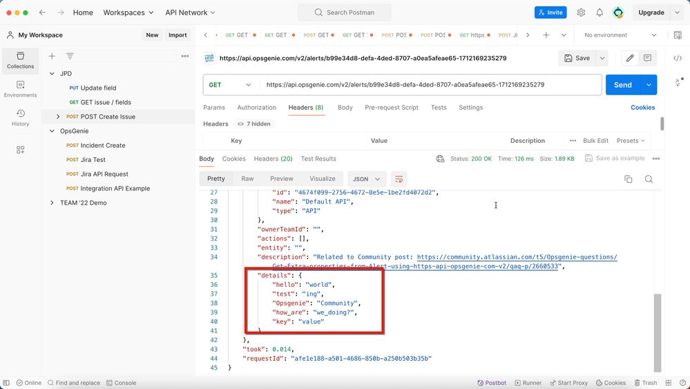

Not sure what parameter you are using in the URL, but can you try running a GET on the tiny ID of that alert to see if you have the same results? Your URL would be:
https://api.opsgenie.com/v2/alerts/87312?identifierType=tiny
This should return the extra properties in the details of the JSON body, and I'm assuming you might be querying on another alert still. For example:
Rakesh Panchal
April 5, 2024
This worked Thanks a lot !!!
If you are running a GET on an individual alert, the extra properties should return in the JSON body without any sort of query needed under the details of the alert:

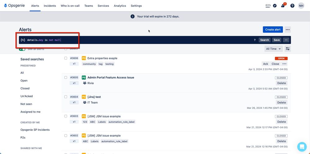

If you are trying to run a GET on alerts that contain extra properties, you would need to query on these using the details since this is where the extra properties parse.
Our documentation mentions using details, details.key and/or details.value - but you could also use something like this as well for null queries:
details.key is not null
After I know the query in the Opsgenie UI, I typically copy / paste it into a URL encoder to ensure I am using the correct parameters in the Alert API.
