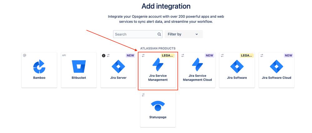

You may add the Legacy Jira Service Management integration from the integration gallery, and ensure your JSM instance has whitelisted the following domain for pushing data to:
If your Opsgenie is hosted in US -> https://api.opsgenie.com
If your Opsgenie is hosted in EU- > https://api.eu.opsgenie.com
For example:

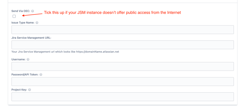

On that integration, you can fill out the form to locate your JSM data center.Screenshot 2022-03-28 at 21.46.39.png
If your JSM instance doesn't offer public access to the Internet, you may need to tick up the "Send Via OEC" option and follow this instruction to install and configure an Opsgenie Edge Connector to assist with data transmission.
Also, you will need to further whitelist the following domain to receive data from:
If your Opsgenie is hosted in US -> https://sqs.us-west-2.amazonaws.com
If your Opsgenie is hosted in EU- > https://sqs.eu-central-1.amazonaws.com
