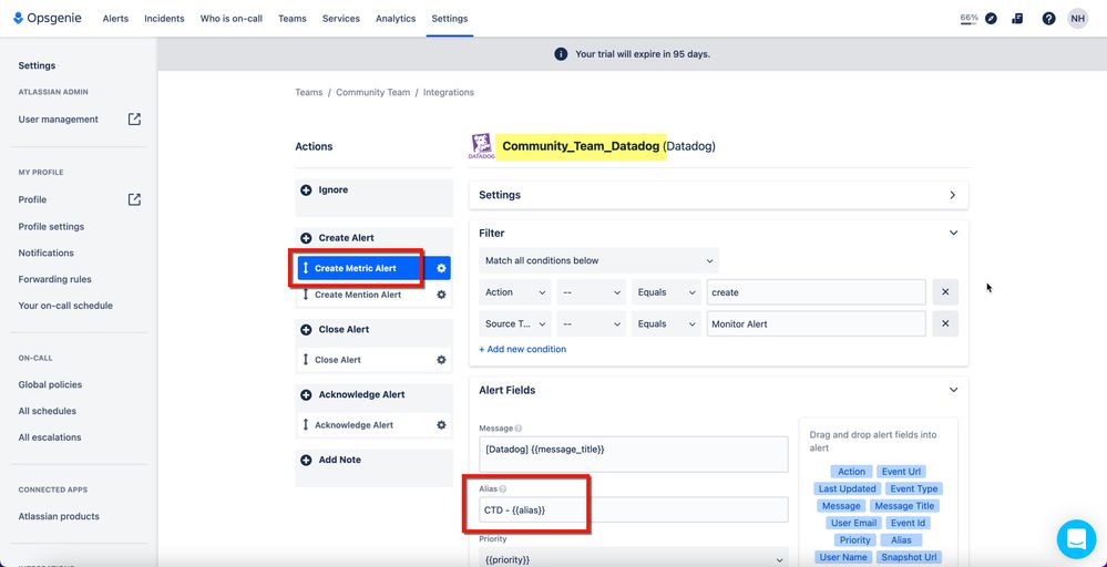

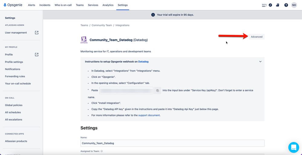

You can edit what data parses in the alias field under the integration's Advanced tab. We see most customers adding a string of hardcoded data such as the integration's name to differentiate the alias for each alert:

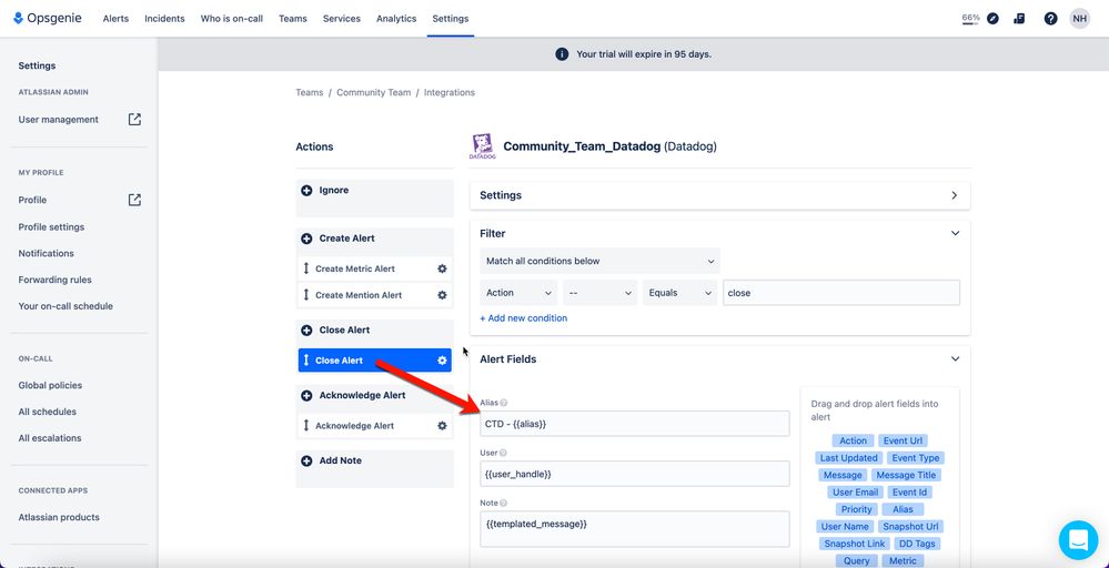

Note as well that if you edit what parses in the alias field of the Create Alert action, you'll want to consider editing this in all other integration actions so Opsgenie can identify which alert to also close, ack, etc. through the integrations. Whatever parses in the alias field should be consistent throughout the integration:
Lastly, the Advanced tab is only available on the Opsgenie Standard and Enterprise plans (and JSM-OG Premium and Enterprise plans). If you do not see this tab, then you plan does not have this functionality - and unfortunately there isn't a workaround.
