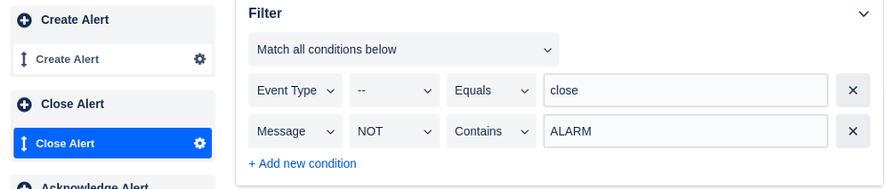

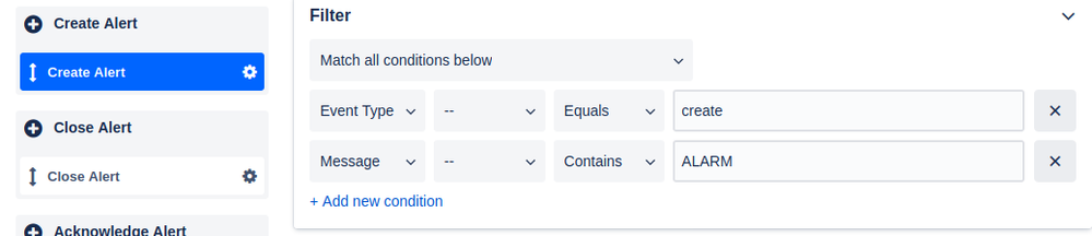

Hi Andrii,
It looks like you have added another condition in those actions along with what the default filters are;
Create action default filter: Event Type = create
Close action default filter: Event Type = close
Not to say addition conditions can't be done, but have you tried testing with the default filters?
Without review the logs of the alerts that were created for "different alerts generated for ALARM and OK events," this will be difficult to troubleshoot.
If you're comfortable doing so, feel free to share screenshots of your logs here - but don't feel like you need to if you do not want expose any private information. Otherwise please open a ticket with support@opsgenie.com and I can help there. You can even reference me and our conversation, and I'll pick it up.
-Nick

Hi Nick,
Incoming data contains string
message [AmazonSns] ALARM: "host-name-001"
I configured alias {{ subject.substringAfter(":") }} in Create Alert and Close Alert actions and filters:
Create alert:
Event type equals create
Message contains ALARM
Close alert:
Event type equals close
Message NOT contains ALARM
But all the same, different alerts are generated for ALARM and OK events

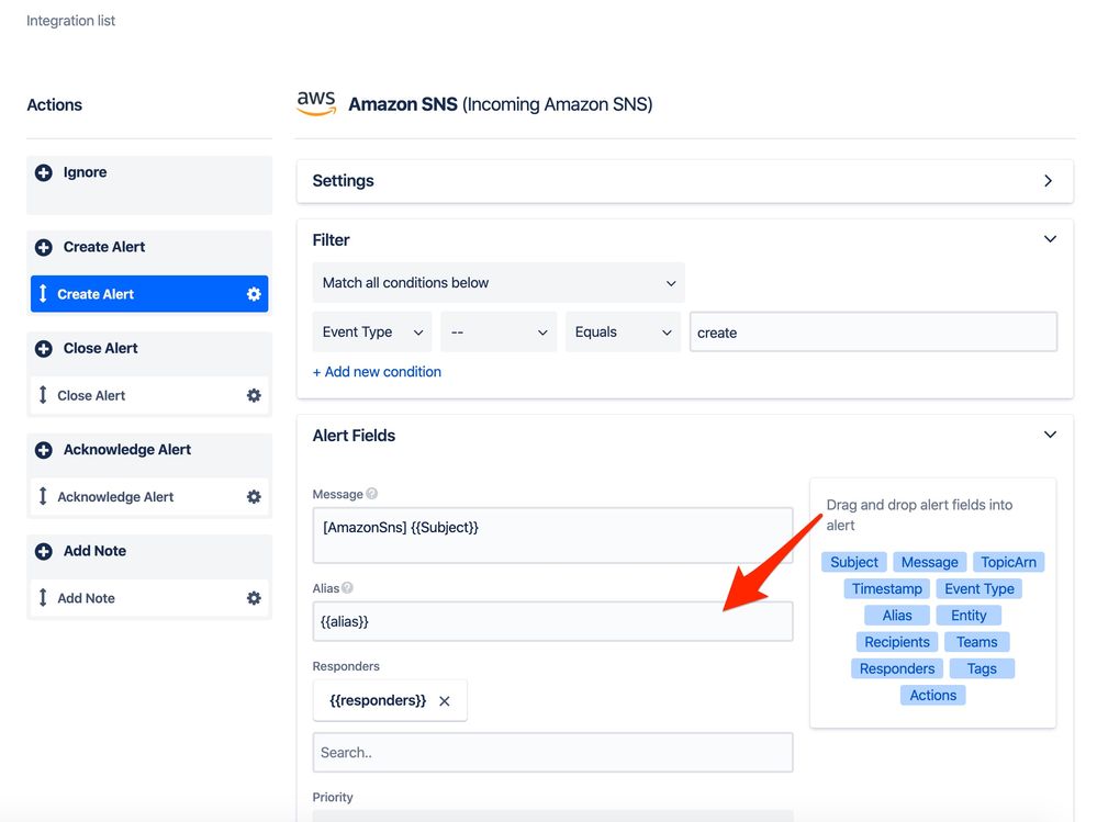

Hi Andrii,
That would be dependent on what dynamic field the hostname is being parsed in on the integration. You can drag and drop these fields to specify what the alias will be in the different actions such as Create or Close:
If the hostname is not parsing in any of these provided fields, but is parsed in the payload of the alert -> then we see customers using some form of string processing or regex to extract the data into the alert fields / alias:
https://docs.opsgenie.com/docs/string-processing-methods
https://docs.opsgenie.com/docs/regular-expressions
It might look something like {{_payload.substringBetween("hostname:",",") }}
The logs can be reviewed under Settings -> Debug -> Logs. You can search the timestamp and look for the SNS processed/received integration logs.
