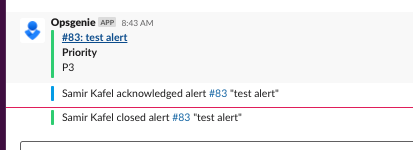

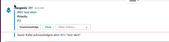

If the alert is acknowledged in Opsgenie, a message will be sent to slack showing that the alert was acknowledged (you can also disable this if you don't want a slack message when an alert is acknowledged). This is detailed on our Screenshot_SlackAlertAck.png

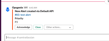

Apologies, I didn't see your reply. I'm not sure I understand the question. When an alert is created, it is sent to the slack channel with a color of red
When that alert is acknowledged the color will turn to blue, and another message will appear showing that the alert is acknowledged
When that alert is closed, the color will turn to green, and another message will appear showing the alert is closed
