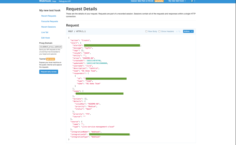

The webhook data includes the alert activity (create, acknowledge, etc.) as well as a subset of alert fields (such as the alert ID, username, alias, etc.) which can also include custom headers to add to the Webhook call.

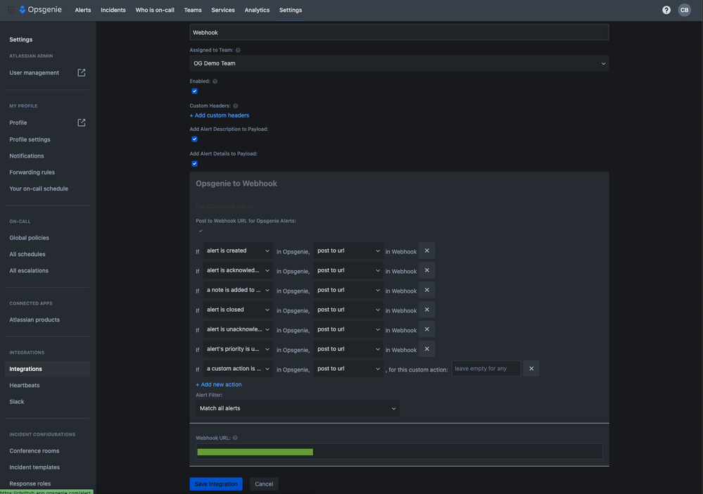

Create a new integration
  1. Once you are logged into your site, navigate to the Settings > Integrations page or from Teams > Integrations and click Add Integration.
    1. Please note that this can be a Team or Global level integration, depending on your JSM/Opsgenie plan and also is not required to be assigned to a Team. This is because this is being used for "Outgoing" Alert information from Opsgenie.
  2. Search for 'Webhook' in the search bar and select that integration
  3. Select Add Alert Description and Add Alert Details to the Payload
  4. Choose the Opsgenie to Webhook Actions you want to use
  5. Add any Alert Filters (using conditions) to the Integration so that it will only send out the info to the Webhook from Opsgenie when it meets those conditions.
  6. Add the Webhook URL from the third-party integration
  7. Save the Integration and feel free to test it out! :)
Screenshots of setup and end result with a test webhook example
