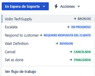

I am looking for the best way to automate the integration between Jira Service Management (JSM) and Jira Software, specifically in the following area:
Status automation
  • Is it possible to synchronize statuses between the JSM ticket and the Jira Software issue so they reflect the same progress?
Those statuses shown in the image are the ones we have in JSM.
Any insights or recommendations would be greatly appreciated.
Thank you in advance!

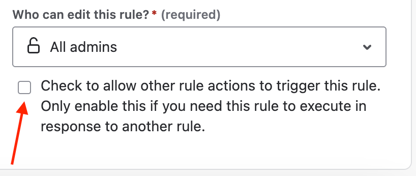

Another point to consider.
Would there ever be a case where you use an Automation rule to change the status of one issue, and need that to change the status of the other issue?
If so, one or both rules might need to have this option enabled in the Rule Details.
That could lead to an infinite loop in automation rules; i.e.
- JSM rule monitors for change to JSM issue status and updates Software issue status.
- Software rule monitors for changes in Software issue status and updates JSM issue status.
Normally you would want only one of these to run. If the JSM rule executes and causes the Software issue status to be updated. you don't then want the Software rule to run (detecting that automation changed the Software issue status) and try to change the JSM issue status.
But, if you have a third automation rule that could cause one or the other issue's status to change, then you would want the JSM or Software rule to run, to cause the changes in status in the other issue.
But if you enable the option to let the rule detect a change made be another automation rule, then it detects changes made to the Status by any automation rule. Thus potentially entering a loop of automation rule executions.

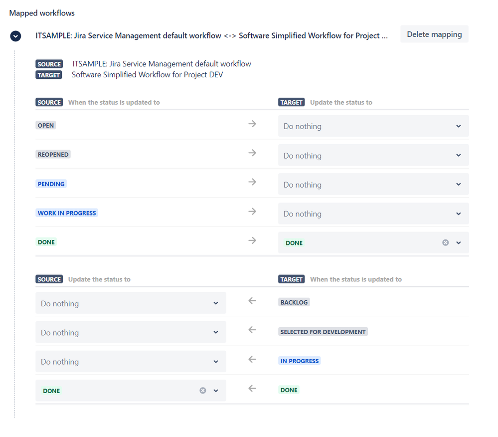

Hi @Julian Andres Carvajal Bedoya
If you want to synchronize statuses between a Jira and a JSM ticket I can suggest trying our app Elements Copy & Sync. You'll be able to map workflows from different projects so that they reflect the same progress as you requested.
Don’t hesitate to try the app for yourself it's super simple to set up and it’s free for 30 days.
