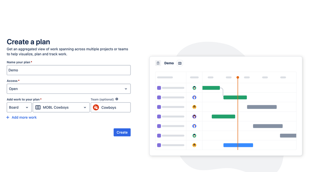

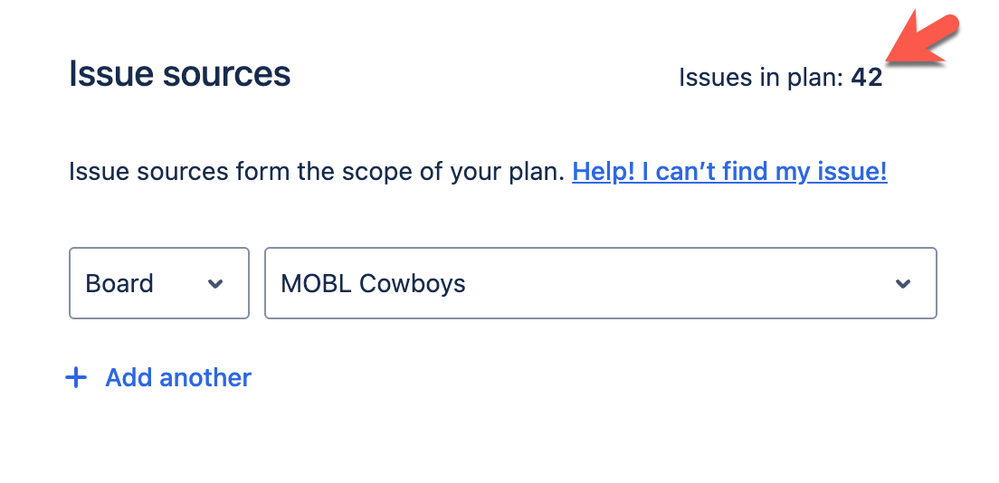

Plans have an upper limit of 5,000 issues on the plan. This was previously displayed on the Create Plan screen and was very useful. I’m not sure why it’s not there any longer, but I have a workaround! When creating your plan, just add one issue source. Then, go to the plan settings -> Issue sources to add the rest. That will let you see the number of issues being added to the plan:
Create Plan:   Plan settings - Issue sources:

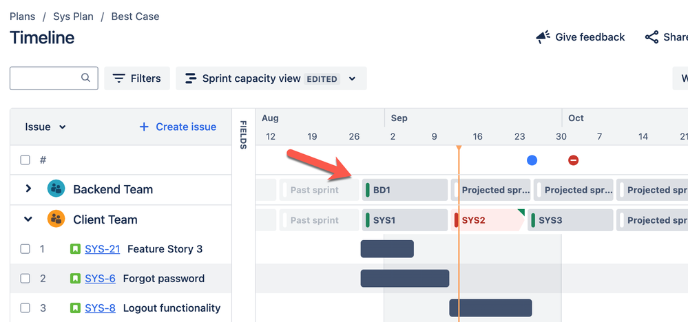

How to get Scrum sprints on the board:
If you have scrum teams, there are a few things you’ll need to do in order to get your team’s sprints and capacity added to the board so you get the following in your view:
  1. When creating your plan, be sure to add issues for Scrum teams via the board. Sprints are part of the board, which means they won’t be available if issues are added via the project or JQL.
  2. Make sure you have associated a team with your issue sources in the plan settings and entered the team's capacity. I use organization-shared teams, so I can reuse the team on different plans, etc.
  3. Speaking of teams, you’ll need the team assigned to your issues via the team field. You can do that in bulk for all issues in your board by finding the board’s filter from the Filters drop-down at the top of Jira, just go to All Filters.
  4. Lastly, under View settings, make sure you are grouped by Team, with Show capacity on timeline checked:
Now you’ll see the sprints from your project on the timeline, with projected future sprints for ones that don’t yet exist.

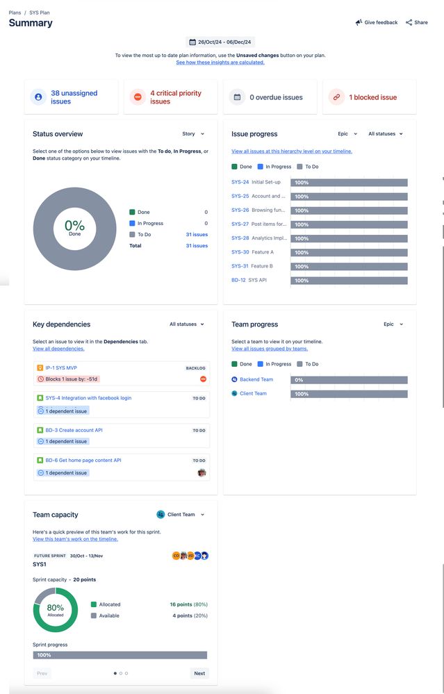

@Ankit Litoriya - Have you reviewed the summary page of Plans?  It's accessible from the upper left corner:
and looks like this:

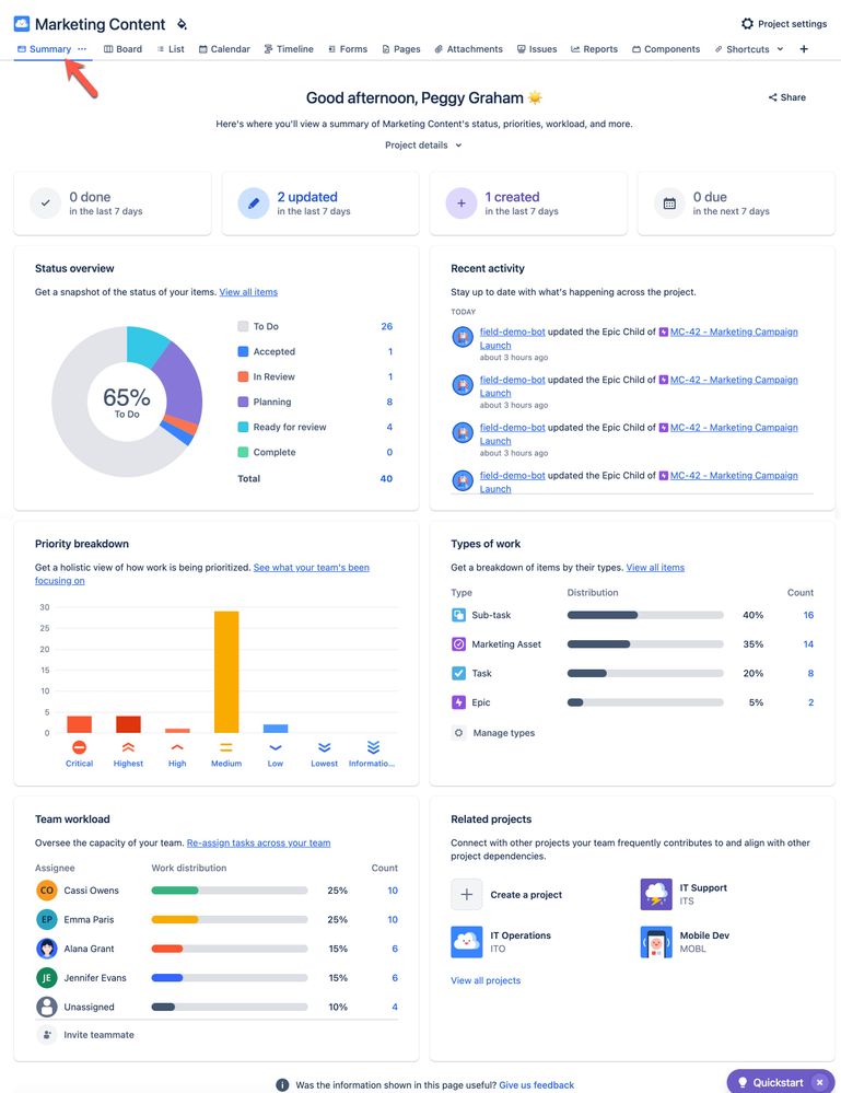

You'll see at the top that it has a date range, which you can change.  This view provides a nice overview of everything going on across all the work you've brought into the Plan.  It's Jira software  project centric (as are Plans in general).  There's also a single project summary like this in all Jira business projects for those that are less driven by stories, sprints and dependencies:
If that's not what you're looking for, then I have some other ideas...  One idea is a Jira dashboard with widgets that show just the Jira issues you are concerned with, giving you a single page to view everything or do you use Confluence?  Another option is to use the Jira macro on a Confluence page to display the Jira issues you want and you can also add any other context, etc., to the page.
