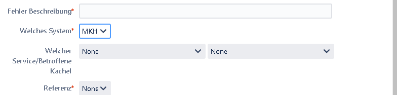

Cem Tuğrul
November 6, 2023
I am trying to create issue when I select "MKH" or "None"  for "customfield_25108
the custom field customfield_25203 still appearing

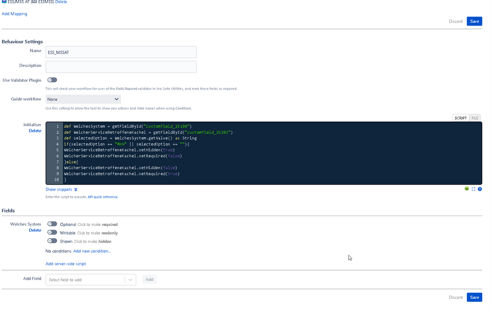

Cem Tuğrul
November 6, 2023
Could it be something wrong while creating behaviour over behaviours screen?
I have done add mapping and selected for my project and issue type

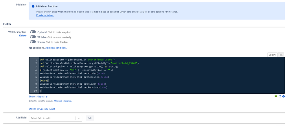

How did you setup your Behavior configuration?  (via initializer or actual field with serverside scripting)
Best, Joseph
Cem Tuğrul
November 6, 2023
from behaviour directly amd made mapping
Cem Tuğrul
November 6, 2023
from behaviour of jira and made mapping for project and issue

when the value "MKH"  the other custom field(under) still appearing or when it is "None"
Joseph Chung Yin
November 6, 2023
@Cem Tuğrul -
Thanks for your update.  In this case remove the initializer setup and move the script code against the "Welches System" field and add the script codes using "Add server-side script" option.
Best, Joseph

Cem Tuğrul
November 6, 2023
still nothing has changed
