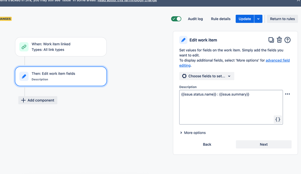

Create the following automation:
Trigger: Work Item Linked
Action: Edit work-item: YOUR CUSTOM FIELD, Value: {{issue.status.name}} : {{Issue.summary}}

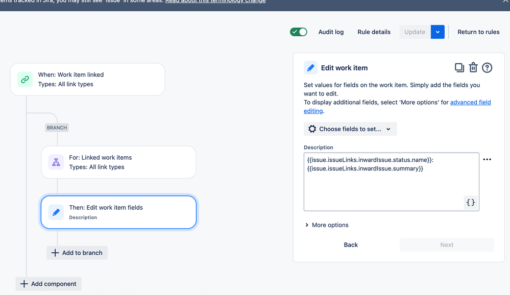

Trigger: When work item linked
Branch: On linked issue
Edit work item:
{{issue.issueLinks.inwardIssue.status.name}}: {{issue.issueLinks.inwardIssue.summary}}
The way it works, when you link a Bug - the trigger is set to work on the Bug and so it will look on its linked issue and will copy that fields to it.
You'll just need to set which field you want to update.

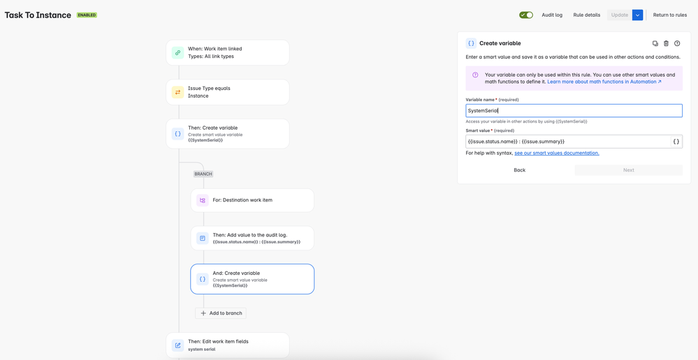

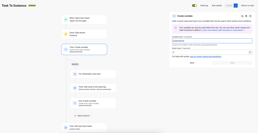

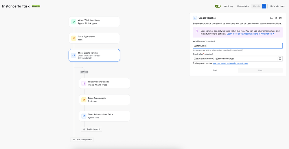

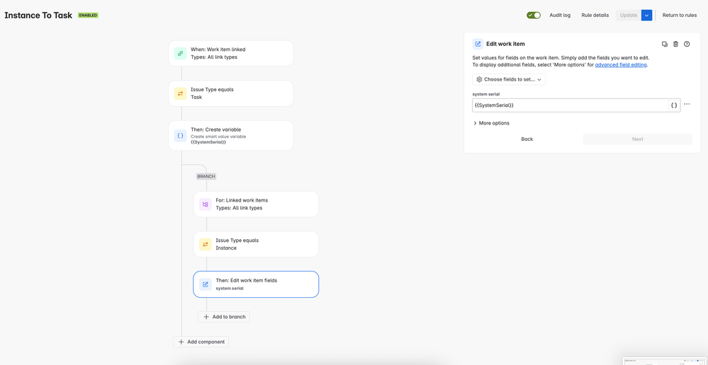

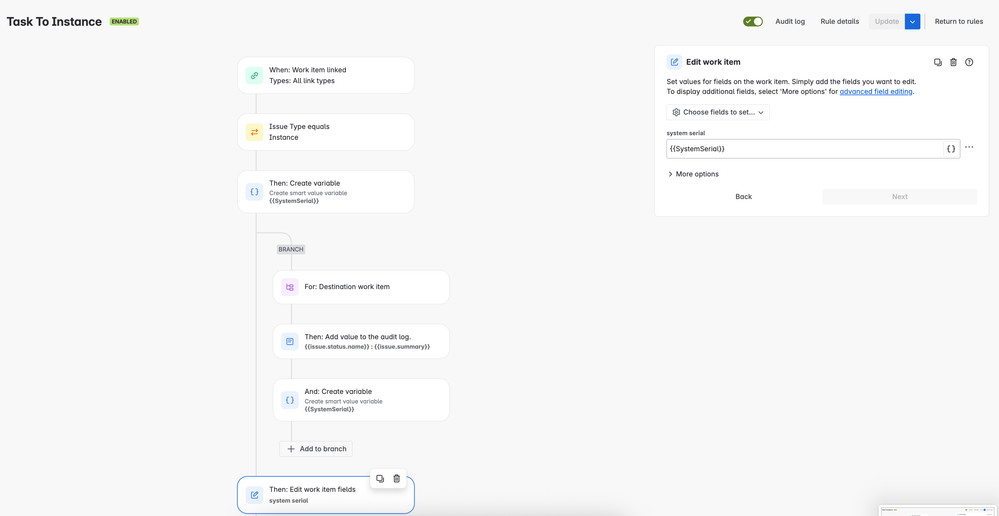

arielei
June 10, 2025
Hey @thumuluru.shreya
Due to IF Else limitations that can not save vars out side of a branch, you will have to split the automations into 2 automations:
1. Instance to Task - where you link a work-item from Instance.
2. Task to Instance - where you link a work-item from Task.
see images:
Instance To Task:
Task To Instance:
Screenshot 2025-06-10 at 17.54.13.pngScreenshot 2025-06-10 at 17.54.22.pngScreenshot 2025-06-10 at 17.54.26.png
