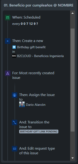

The issue is created by an automation with the following characteristic:

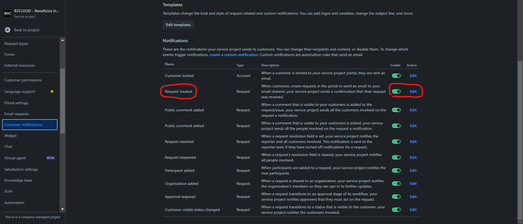

I clarify that the automation is working correctly, the problem is that the reporter does not receive the email when the issue is created. Customer notifications are enabled

The issue with your automation is that your automation created the issue, so the actor of the rule is initially set as the issue reporter.  Afterward, you edit the issue.  The edit issue event may not trigger a customer notification.

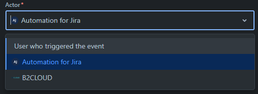

Please advise who is the rule actor.  Once when the issue created, who is listed as the reporter.

- The actor rule is "Automation for Jira".

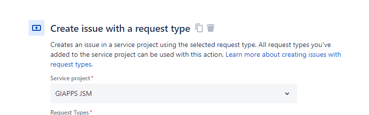

After looking at it further, you should use the action instead of "create issue"
It is because only at the issue creation time, if the issue has a valid request type, then it will be visible to the reporter of the issue.  By default, when one creates an issue for the JSM project, he/she uses the portal UI and select the appropriate request type to create the issue.
So this means that when your issue is created via the automation rule, it will already be valid/visible to the reporter in the portal - thus the notification will go out to the reporter.  Lastly, you don't need to edit the request type at the end of your automation rule.
Hope this helps.  Give it a try.
