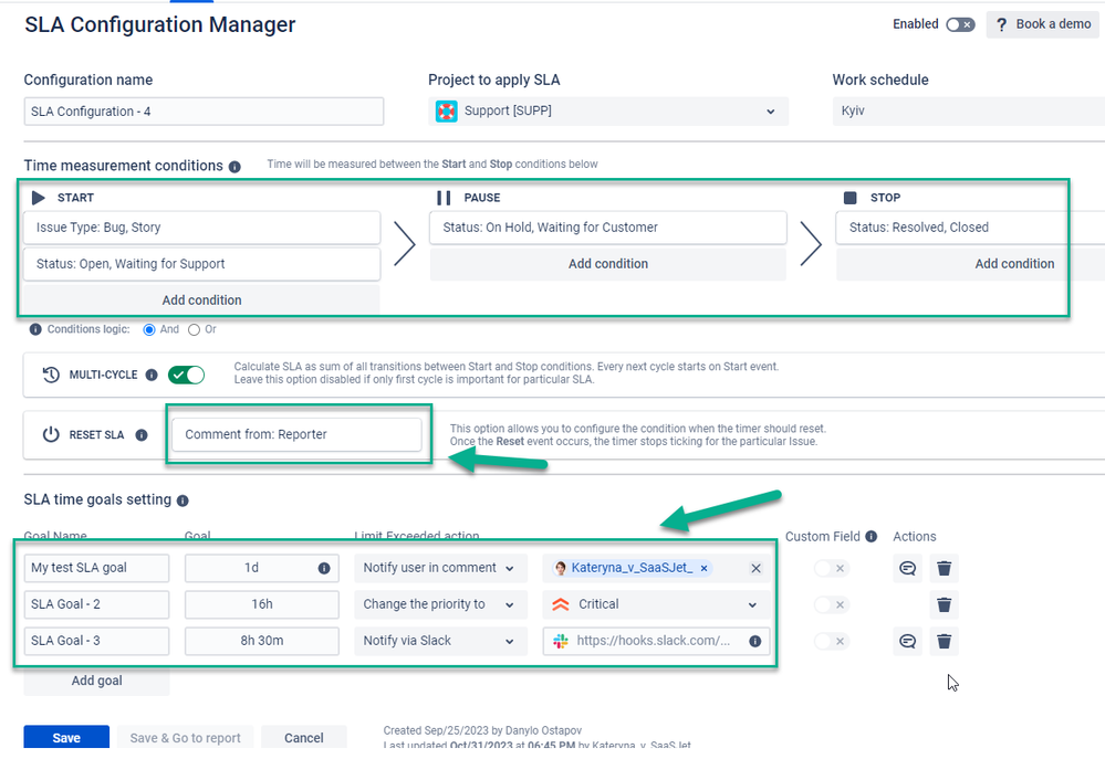

Kateryna_v_SaaSJet_
Atlassian Partner
November 30, 2023
If this is a stable problem, then I would recommend that you set up notifications to approvers sometime before the deadlines. But if the client side has to approve, it can be set as a condition for SLA Pause.
If you are not against using third-party apps, I will show you an example of such settings in the SLA Time and Report for Jira add-on, which my team developed.
You can customize this for your project as well. The add-on is free for teams of up to 10 users and has a 30-day trial, so give it a try!

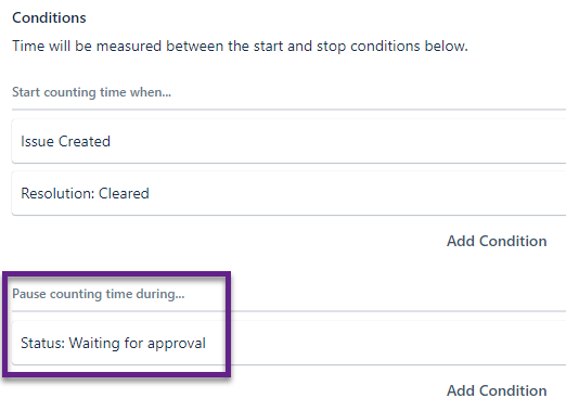

Rick Westbrock
August 28, 2023
In the SLA configuration in the Conditions section there is a "Pause counting time during..." section where you can exclude a status. If you have a discrete status which requires approval such as Waiting for Approval then just exclude it from the SLA timer so that agents don't get penalized for approvers taking too long to respond.
