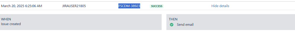

and email logs looks fine . however i cant see any email notification created for the time as an issue is created. jira_2.PNG
