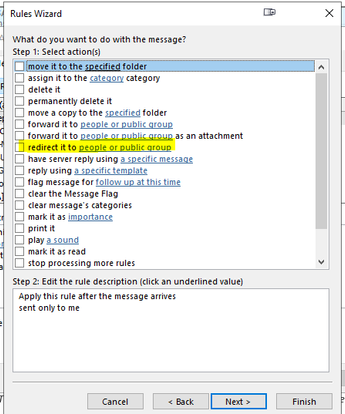

How can I create more email addresses or if not possible how can I realize this in another way? I have already tried mail forwarding, but then the reporter is changed.
If you're using Outlook, one of the rules is "Redirect". This actually bypasses the original recipient and sends the email to the address you input.
So for example, if you set this up to redirect to 'support@yoursite.atlassian.net', the tickets will be logged by the original sender, as opposed to 'it.servicedesk@...'.
You can set as many addresses to do this.

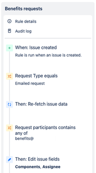

A JSM project can only have one email address associated with it, but you can work around it by forwarding to it from other email addresses. I have a project that have 3 different email addresses that is forwarding to it and then I am using automation to set the component based on what email address was used (it is added as request participant).
Hi Mikael, Do you have an example of the automation you have made. I did not succeed to create a working automation for this.

Here is the automation that I have in place for our benefit email:
