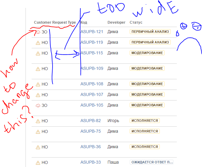

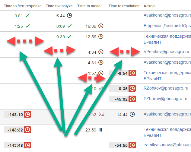

But how to rename time fields and query type? Just the names are very long and in the columns it is not convenient to follow, many occupy places.

Ah, no, you can't change that.  It's wide because it expects you to use informative request type names.

калонки.pngyou serios? :(
Nic Brough -Adaptavist-
June 20, 2017
About the customer request type, yes.  Your HO is a very poor name.  The times, yes, they might be a little wide sometimes, but take a look at the "overdue" boxes which could easily fill them

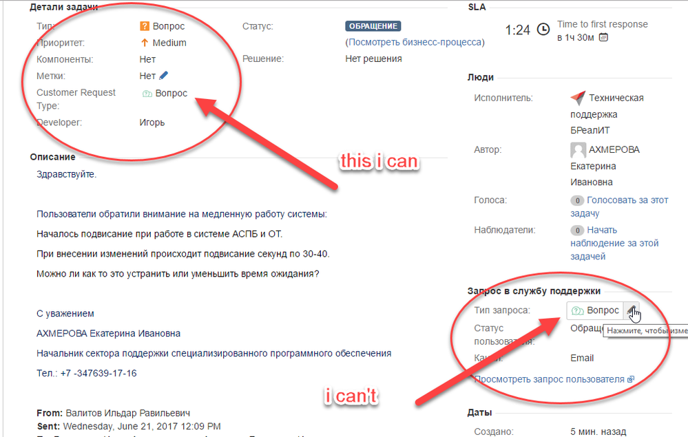

 Yesterday I bought the application on the mobile, and the counter is that the notifications come normal then when the application has the type of request. (The type of task is changed in the application, but there is no request type)
Both in the browser and in the browser, I can change the task type in the task detail block, but I can not type the query, I can change the request type only in the support request block.
Is it possible to somehow make the field active for a change in the task detail block?

Yes, the request type is part of the request, not the issue.
Kseniia Kuhar
June 21, 2017
You did not understand me. How do I change the type of the request not in the "requests to the service" block but in the "task details"
