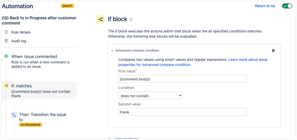

At a very basic level I could easily use the condition "does not contain" the word "thank" - which will work!

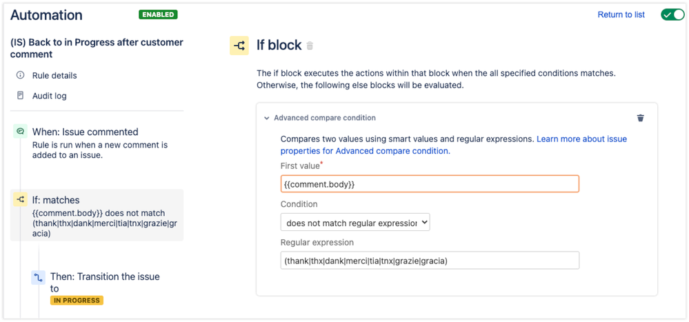

The automation will look like
However I realised a strange behaviour:
  • When using the condition "does not match regex" the issue will be re-opened no matter what the reply is - so even if the comment contains something from the regex
  • When using the condition "contains regex" OR "exactly machtes regex" the issue will remain resolved - no matter what the reply is

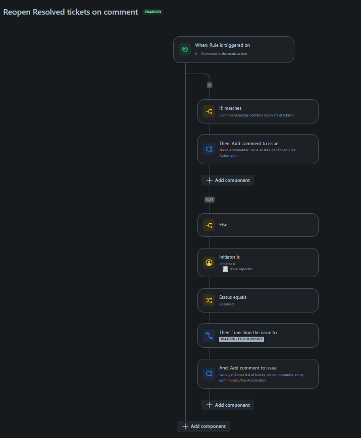

* New If Else condition

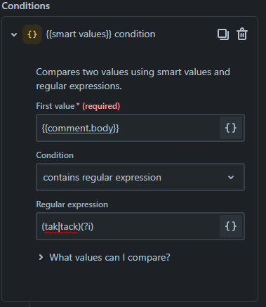

* If Condition:
Screenshot 2024-02-22 144005.png(Regex looks for "Thanks" in danish and swedish, with a case insensitivity flag)

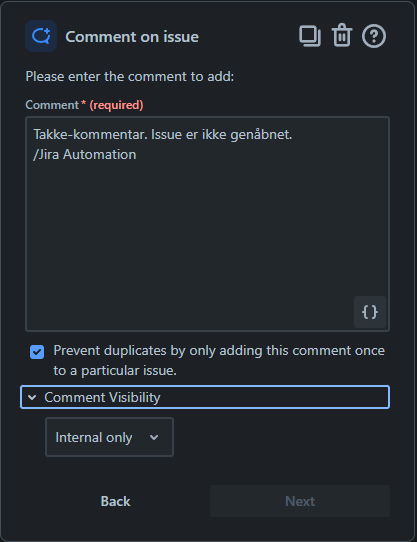

* Dummy action on the if condition: Screenshot 2024-02-22 144131.png
* My full tree looks like this, with the actions I actually wanna take if the regex DOESN'T match under "Else":
