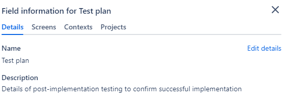

@Maurice Meyer the mouse over field that you are showing is from the Description set up as part of the field creation:
As such the mouse over is internal not customer facing so there is no mouse over on the portal for this.

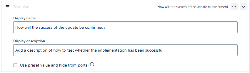

The way I've got around this is to add a description to the field that will appear below the portal entry.
In the image below I have given the Test Plan field a more user friendly description under 'Display Name' and also added a 'Display Description' that will take the place of the mouse over (to get to this use the expand arrow to the right of the field):

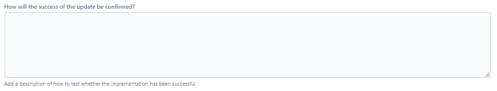

When this is displayed on the portal, the Display Description will be shown below the portal entry field:
