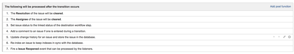

  • In the workflow: sometimes it is added to the workflow as a postfunction and it could look something like this:

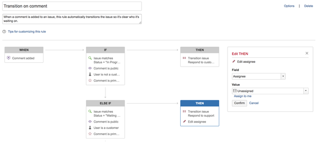

  • Another major possibility in JIRA Service Desk is the automation engine, making up the rules for behaviour in issues, which probably also tells the issue to change status when a comment is placed. If you can find it there, just edit the rule to no longer unassign the issue on transition
