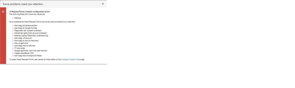

in my Jira Service Project, i created a new custom field with the dropdown type in place of the radio button, so i unchecked the old custom field from the fieldscreens that i used before and replaced it with the new custom field. Now i get the following problem:
How can i fix this problem!

@Rachid AmajoudIts clear so please click the link at the end " add values to field to fix all request forms"so you must add values to the new field .
Hi Thomas,
that's what i am trying to do, adding this field to the forms, but when i cllick the edit button on the request forms, i get this error on a blank page, not possible to add something. In addition a video about the issue.

@Rachid AmajoudI have seen the video, could you check all field configuration of these screens , is this field required or optional ?
Thomas, how? i think the setting to make this optional is on the setting page of the request type pages, when i open this, i get the error as you can see on the video.
grtz
R.
@Rachid AmajoudYou can make it optional in field configuration, when you click on the field configuration used by this screens you will see the optional option.

I deleted the correct custom field, but i did this when they were still requierd on the resuest type pages. I need a way to make them optional on that page!

@Rachid AmajoudThe new custom field have you set values for it ? and this field which has been shown on the screen that says it has no values is it the new one ?
Hi Thomas, it is the new custom field with the same 'fieldname' the only difference is that the fieldtype isn't a radiobutton but a dropdownbox. The values are the same.

I get this error when i want to edit the request types in JSD.
